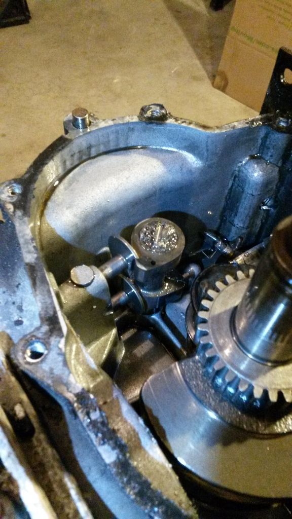

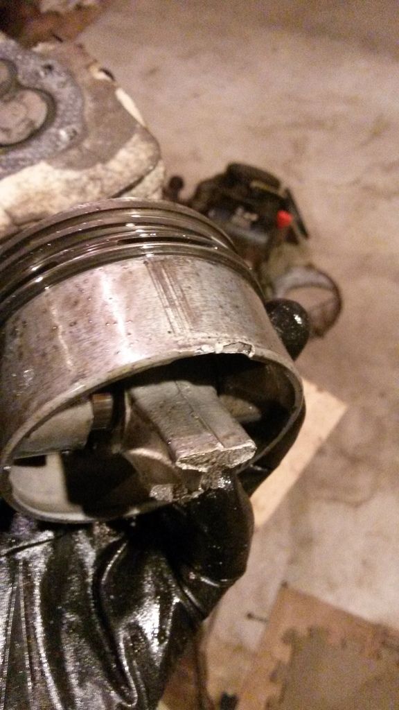

Connecting rod snapped right at the piston...smacked the piston skirt and scored the cylinder.

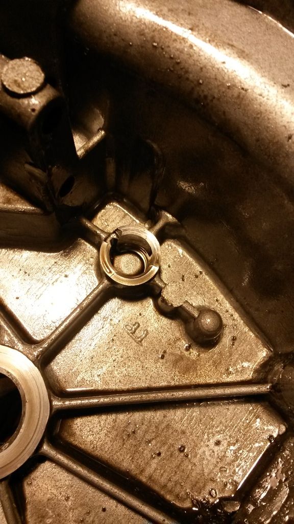

Block-end cam bearing is cracked --> That's the deal breaker right there. Time for a "new" engine.

cracked sump:

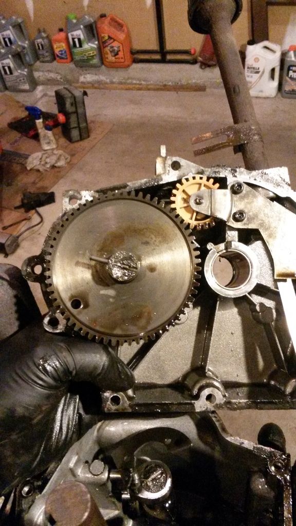

toasted cam shaft:
the cam lobe smashed the lifter and became lodged ...i suspect valve spring float from overrevving
^^^ exhaust valve was also slightly bent
snapped connecting rod, damaged piston skirt and slight cylinder scoring from the dinged piston:
^^^ cracked the block behind the starter as well...

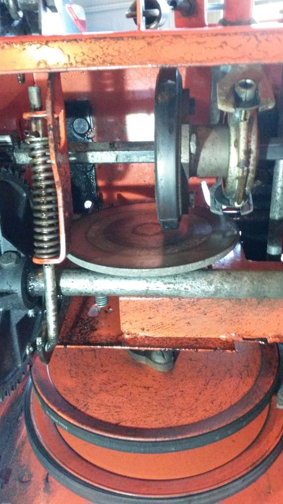

The traction assembly is designed for 1/2 of the RPMs that are generated by a crankshaft PTO...and the chassis is too cramped already to fit a larger friction pulley. If there's a will, there's a way I suppose...I don't need anymore projects!

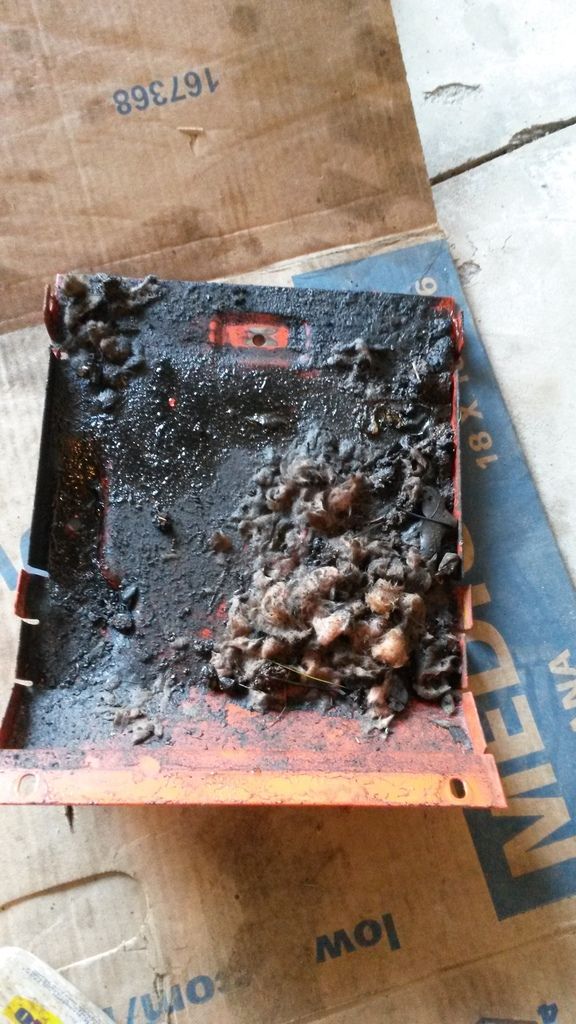

And when I pulled the plug, my nostrils instantly burned ...any of you guys who put any time in front of a parts washer know that smell.
Despite the careless use of parts cleaner, this still appears to be a low-hour engine.
When I popped off the breather, the smell was worse...so there was a bunch of that crud in the sump.
^^ I had no intentions of pulling this engine apart (..I can't speak for my sub-conscience though). I didn't want that parts cleaner ruining a perfectly good engine.
