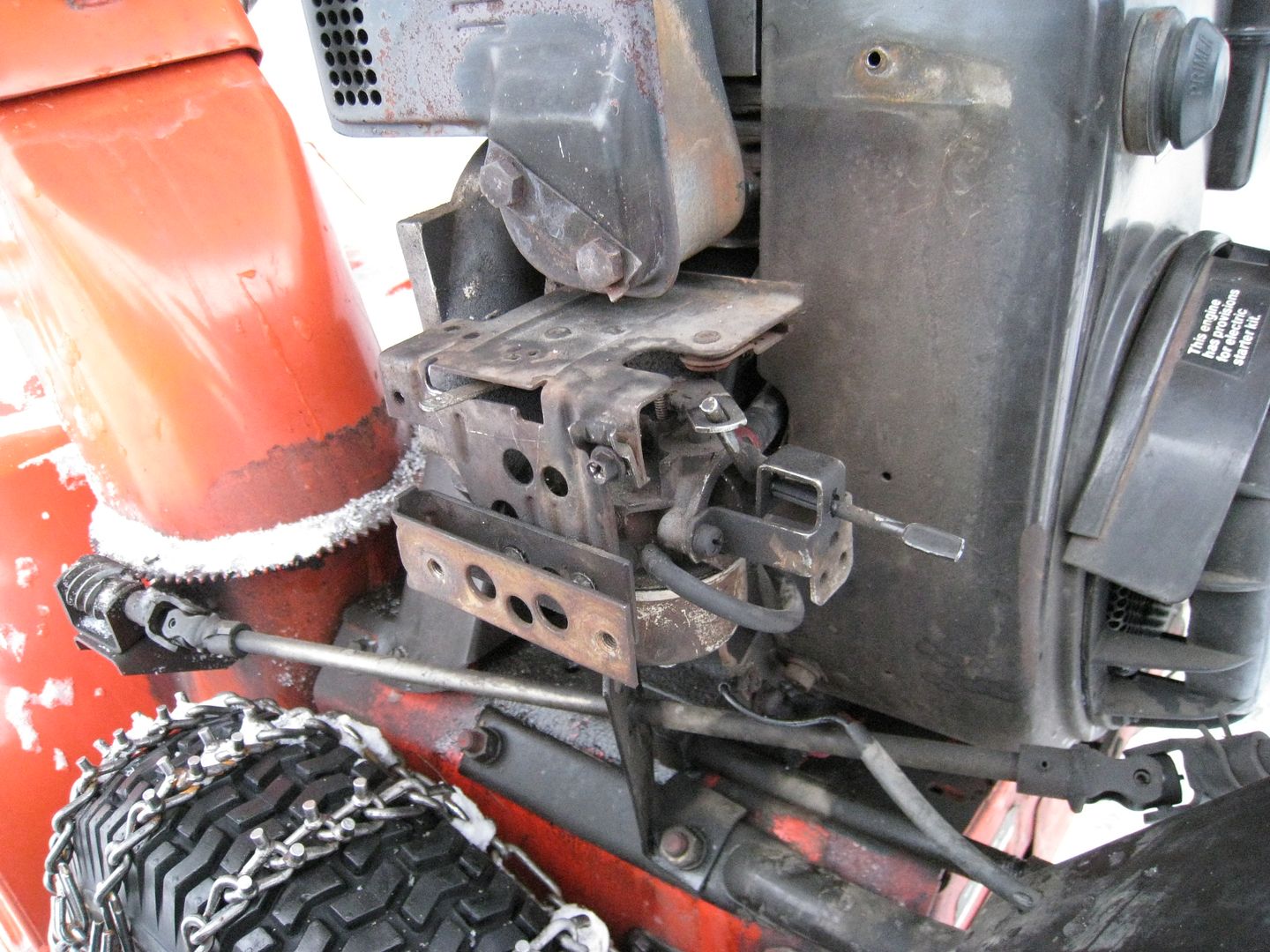

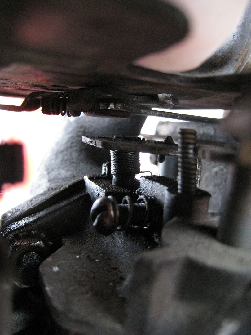

I've got some problems with throttle linkages. the spring that sits on the top of the butterfly valve keeps popping of, and the blower starts revving like crazy. i reset the spring. and then it pops of again. is this spring available for me to buy somwhere? or do i need to get a replament carb?

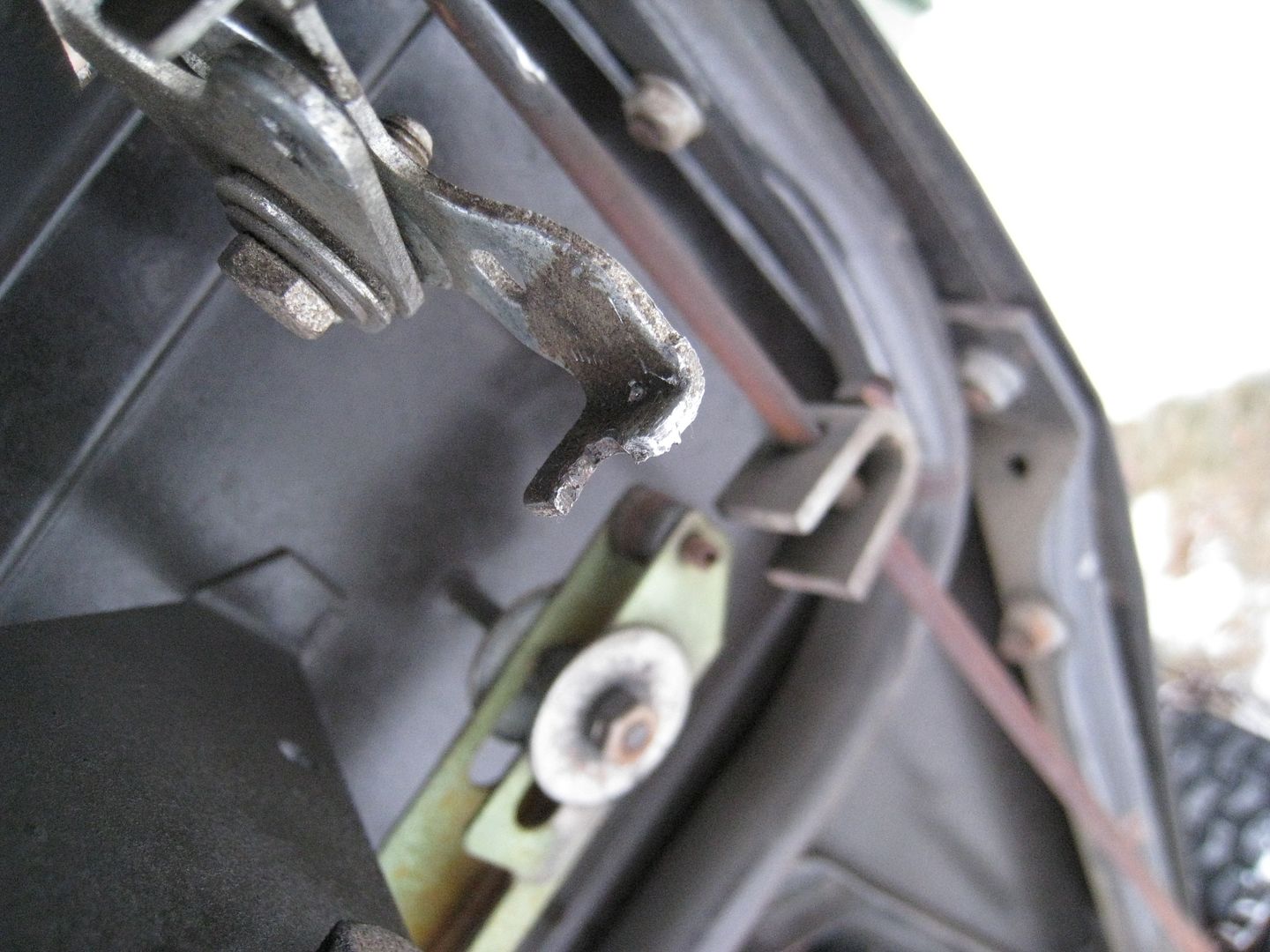

and in the process of taking of the cable, i kinda broke the mounting that the cable sleeve sits in under the throttle arm on the control console.

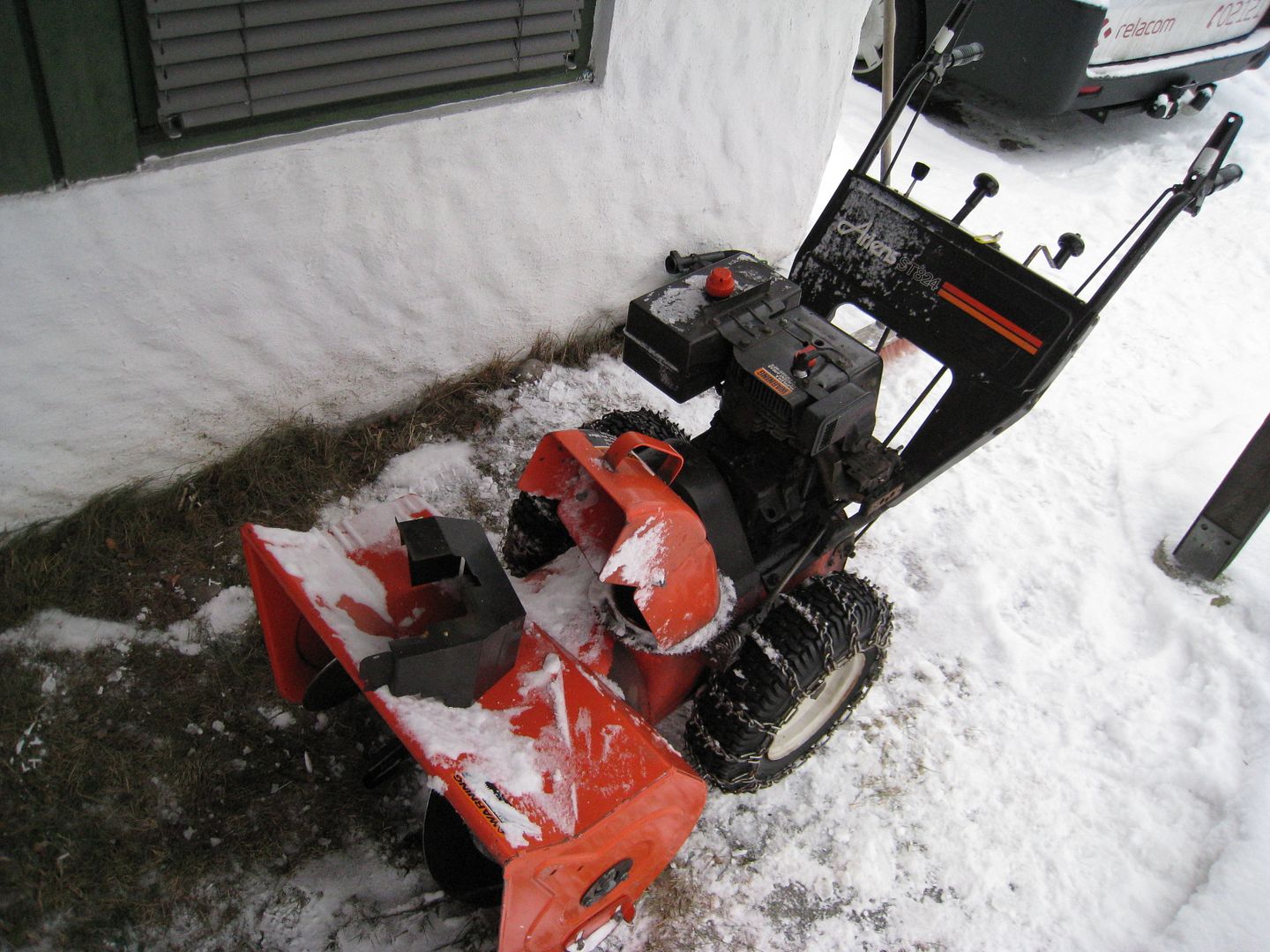

here is some photos i just took
this is the throttle lever which i kinda broka
this is the spring that keeps popping of. making the blower run crazy
overview of the carb
bad pic of the whole blower

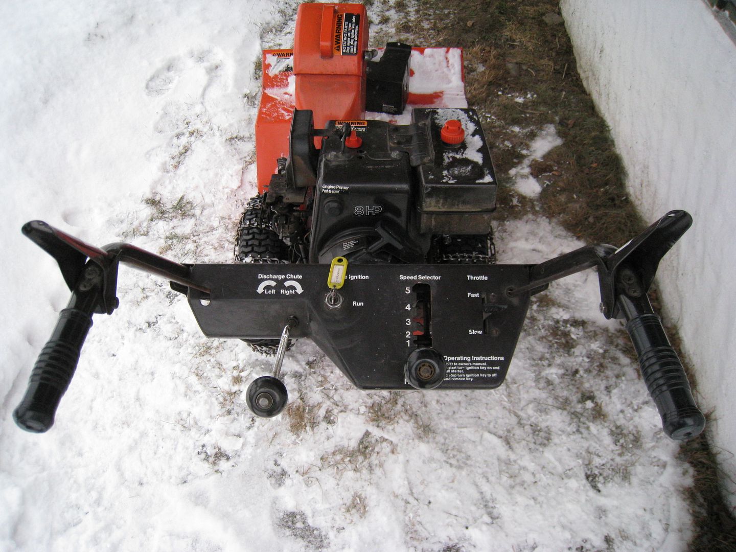

controlpanel. or whatever you want to call it

Welcome Dan, and with your issue of the print popping off, it would appear that the control surface that the spring attaches to, is bent or loose. The acceleration of the engine after it dislodges, as you describe, sounds like the governor linkage is the culprit. A simple "readjustment" of the end of the governor rod with a pair of needle nose pliers should resolve this problem.
In your second picture, there is a spring that wraps around the butterfly shaft, to assist it into the open(high) throttle position. I can not tell from your picture if it is out of position.
You may be able to straighten/retighten this, but this depends on your ability to turn a wrench and in this case use a hammer.
Insofar as replacing the carb, I'd say that a good cleaning, and address the minor issue and you might be able to get away with a low cost fix.
