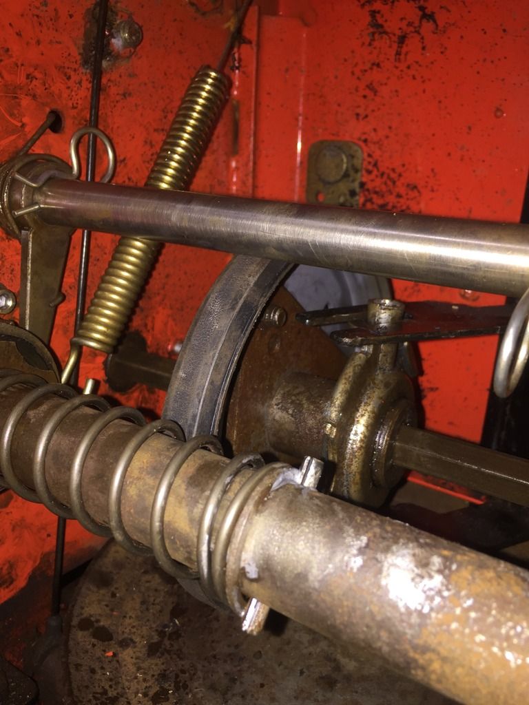

Well gearbox is done....For now anyway lol, New friction disk installed, Had to go buy a new T40 torx as my old one was slipping a bit and the new one worked nicely, Everything is smooth and NO slop and everything is solid, The wheel release however does work, but rather sporadically and is random whether it will lock the wheel or not so I am going to just leave it locked and not worry about it for now. I'm thinking once I get the rest all together and make sure of the reliability of the engine I will be ordering the auto turn kit but that gives me a little time to save. Now I just need to pull the bucket off again and get it back into the garage. So what was done on this? ,

New friction disk
and the dreaded wheel lock that hates me LOL

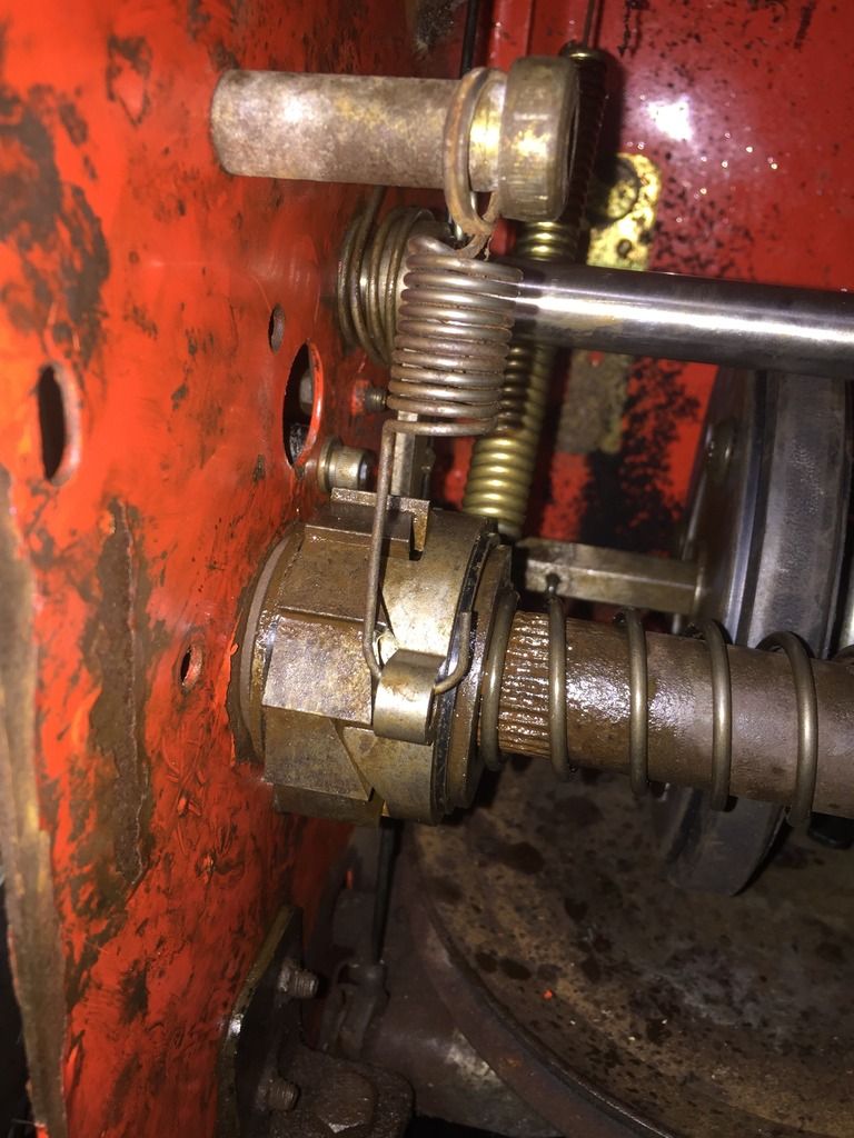

Dauntae, Looks great so far...Couple questions tho: 1) what is that machined piece for? and why weld a washer to it? 2) Axle disconnect looks like it's connected properly...What's it/not doing??? Does the cable pull on that gear? And the gear slide on the splines?? I've fixed 2 this week and that looks correct. 3) Does G/F have a single identical twin?? Doesn't have to be single, matters not to me.

1) the shaft I replaced was badly grooved from neglect and got hammered on by the gear and the hole in the side that holds it was starting to get a bit loose and I've seen on this forum people welding a washer there that the shaft fits in to support it, Shaw351 I think put the post about it too. This one was not that bad but it DID give me a excuse to make stuff hehe, Since I was already making a new shaft I just made is slightly longer to be able to be held by the collar.
2) Everything DOES work properly-ish, But the axle itself was so badly pitted underneath it it keeps getting hung up, This thing was NEVER lubed is my guess and rust was real bad on a lot of areas, To get the axle pieces to replace that pitted parts would cost $80 from the cheapest places I could find, If I was going to spend that much I figure I may as well just spend a little more and get the auto turn, Because either way I would need to get new wheels because these are seriously rust welded to the pitted axle, Tried a torch and got it glowing then pressing the axle in a hydraulic press and not even budged. So I am just not going to pull the lever if a freak snow storm hits before spring.
