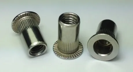

Another possible solution to the loose nut problem is something called a nutsert or rivenut:
Once the nutsert is installed correctly it will not spin as the bolt is tightened. They come in a variety of sizes. Some hardware stores carry them or you can order them from Amazon.
Prime, RIT333, Newt and 1 others like this.
Awesome product ! He may have to cut it down in length. or stack some washers on the outside frame, but sure beats welding if you can't weld.

As I mentioned earlier, The J-Nut comes in all different varieties.... I stock sizes up to reach up to 2" from edge of material. There is also a variety that resembles a lolli-pop....... Where the appropriate sized nut has up to a 12" bendable piece of straight metal, commonly used on trailer hitch installations. I do not stock those, as I make my own as needed. The Riv-Nut* is an awesome repair solution. I have a kit that includes many sizes and a tool. which resembles a large pop-rivet tool, to install them. It is not a
necessary tool, but makes it a whole lot easier to install.
