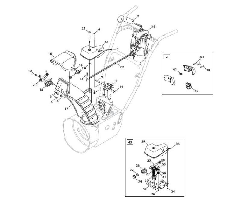

I bought a Troy Bilt Storm 2840 this year from Lowes. Haven't had any real problems until yesterday. The joystick that moves the chute won't turn from side to side at all. It is just kind of hanging there. I'm not sure if there is some sort of gear box inside there that is out of alignment or what the deal is. Any help would be greatly appreciated. I know I should just find a place to take it. But up here in Maine we are looking at three more storms this week alone and if I have to move the chute manually then that is what I will do. Thanks.

It has a rod that runs out of the control box to move it left to right. It's almost like the rod slipped out but I can't seem to get it slid back in where it should go.

The Hex Rod needs to be fitted all the way into the receiver in the control box.
Also, there is a cotter-like pin at the chute end.....do you still have the pin there? if that pin came out, then your control stick won't do anything.
Does the chute up and down work?

The chute still goes up and down and the button you push to move the chute still works. The cotter pin is still there and the hex rod is all the way into the reciever. The joystick spins around in the tube that comes up from the reciever but it seems like the gears don't match up with each other. Guess I will take the box apart when it stops snowing.

When you move the joystick, does the hex rod move at all?
If not, from the breakout below,it looks like you may just want to take the control box apart and have a look inside....
