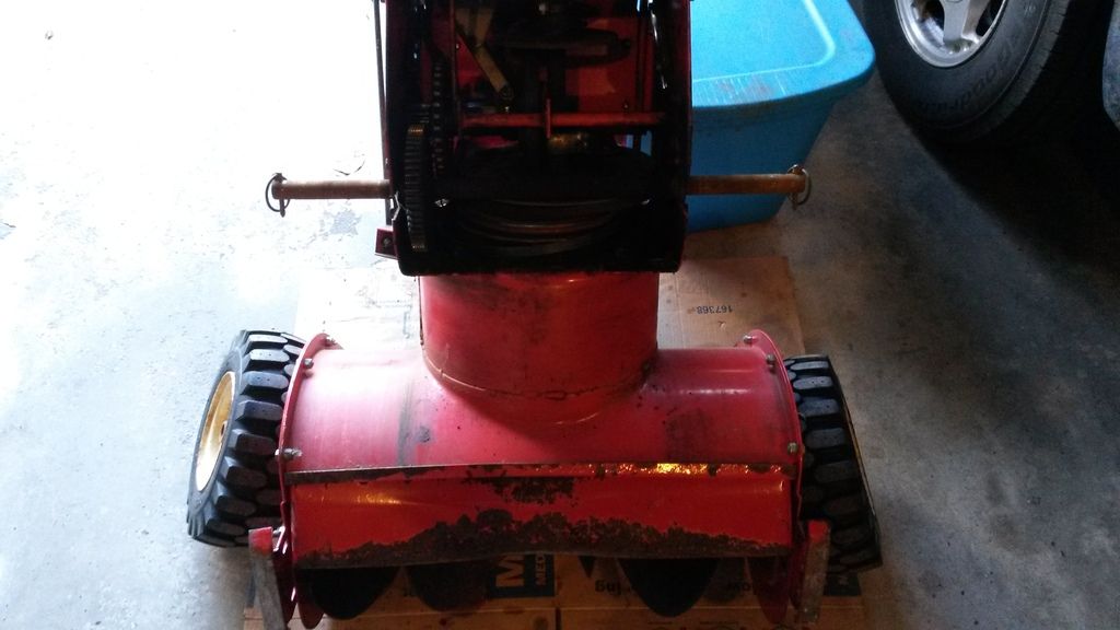

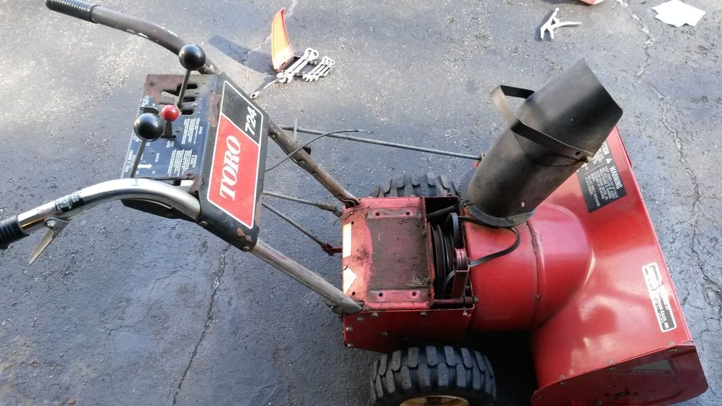

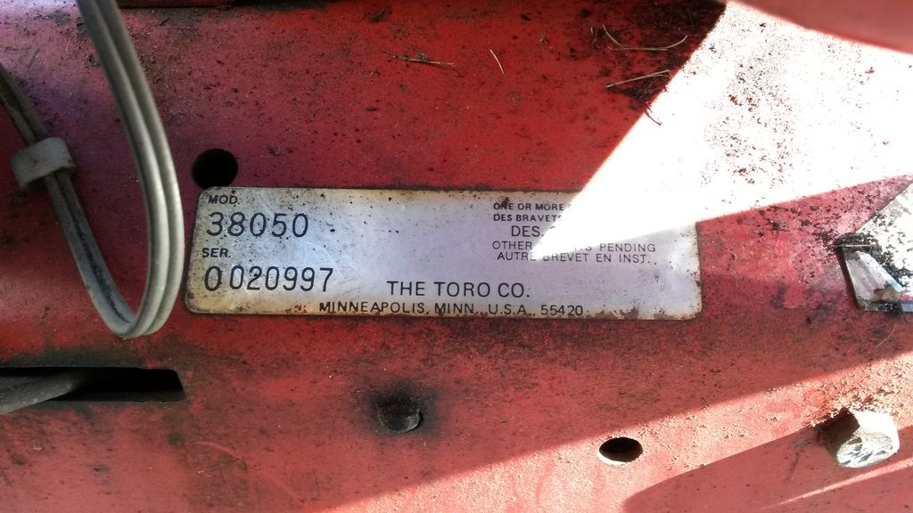

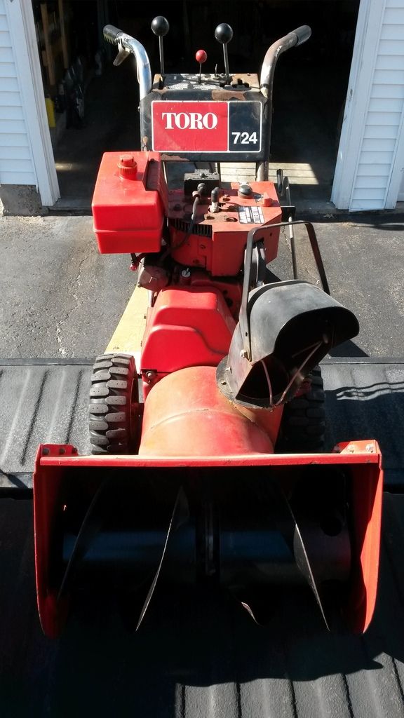

This somehow ended-up in the back of my truck today.
^ 1980
Another member's brother was giving it away ...a deal too good to refuse...especially for old iron!
('95 Ariens ST724)

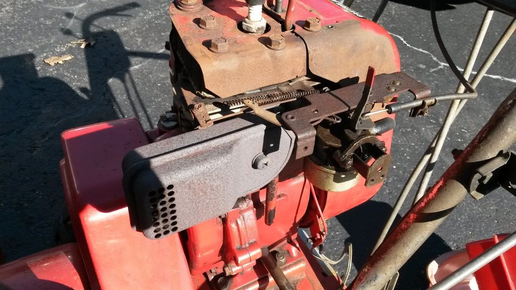

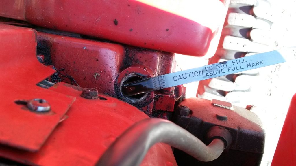

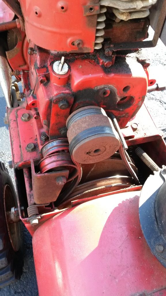

hmmm...wonder what's hiding behind that starter:
^ definitely a broken connecting rod...but the block is definitely salvageable.
oil level wasn't too low...it does have the consistency of 30w though.
I guess it's also possible that the linkage was binding-up.

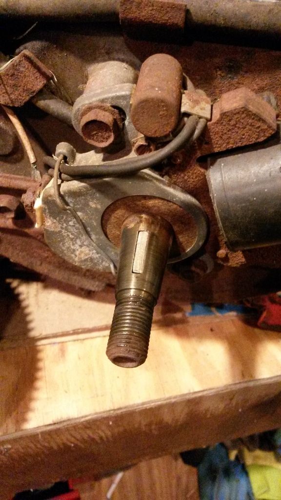

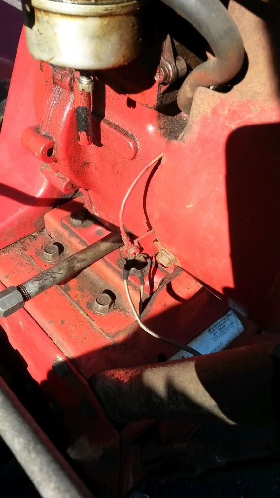

dismantling the engine
Pre-safety module era:

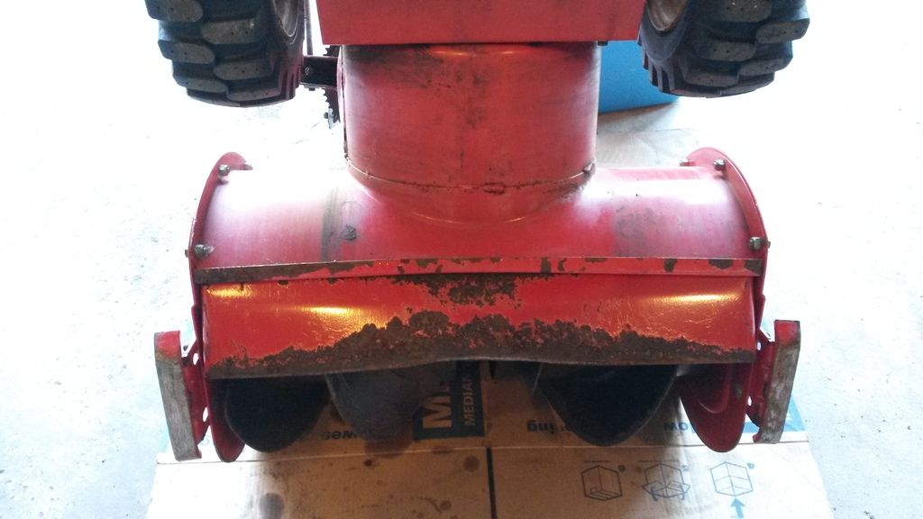

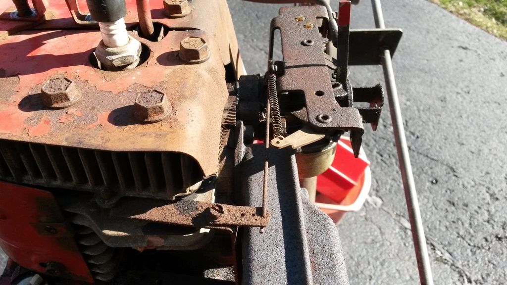

something not quite right with this scraper bar...I could be wrong but I believe it's installed incorrectly (hence the excessively tall skid setting)
Yay! Wheels aren't frozen to the axles!
('95 Ariens ST724)

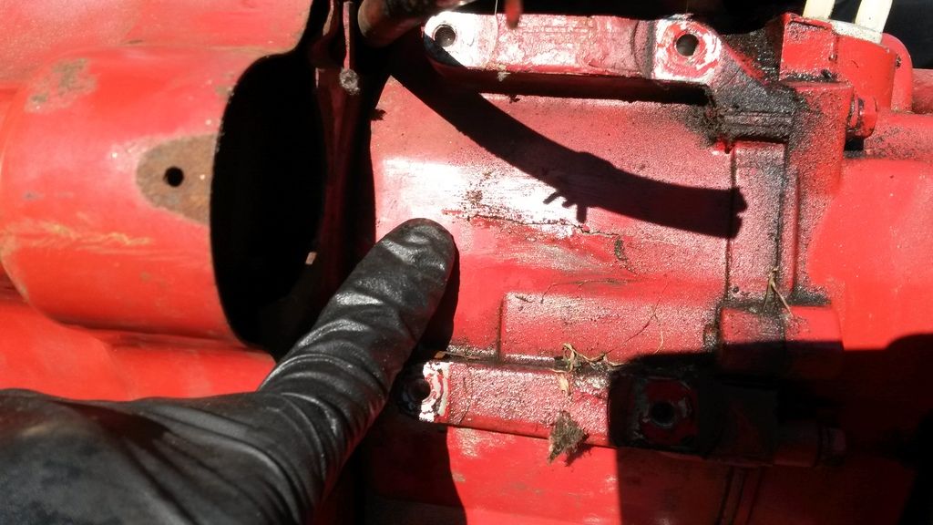

and there's your broken connecting rod.
...and a sheared flywheel key:
The crankshaft, piston & cylinder are in great shape!

It's worth a try to see if it can be repaired. Clean up the crank and get a new connectiong rod and braze the crankcase shut and if it is still a total loss then you can always repower it.

pretty good shape for a 1981, even the paint looks good, maybe wasn't ever in salt, definite candidate for unrestored original condition equipment honors.

My understanding is that she spent her entire 37 years on 1 property.
