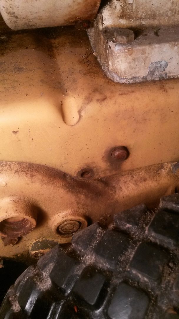

post #17 of 97 Old 12-28-2015, 06:12 PM Thread Starter
Likes (Given): 1632

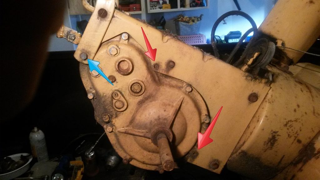

Probably the last update on "Big Bird" for awhile...
...I was hoping to get this Sherman-tank blowing by next weekend however the busted bolts that hold the tranny to the chassis will require me to pull & split the transmission in order to extract the broken bolts (red arrows):

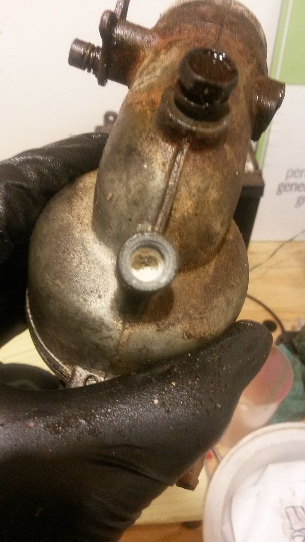

I'm eager to see what horrors lie in the carb bowl however the emulsion-tube isn't going anywhere anytime soon...and on these updraft carbs, you can't split the carb until the tube is unscrewed from the carb body.

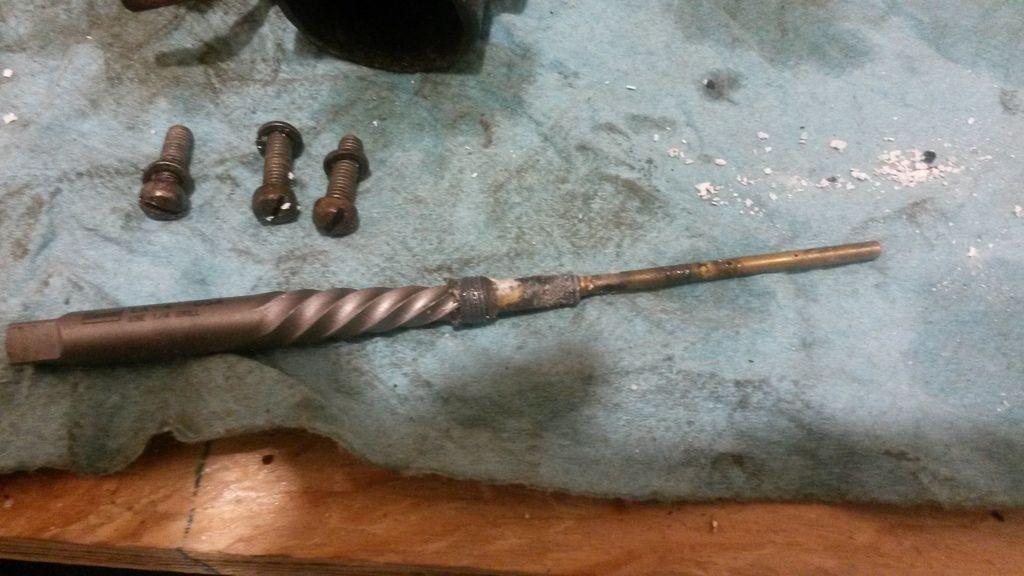

^^^ ok...I lied

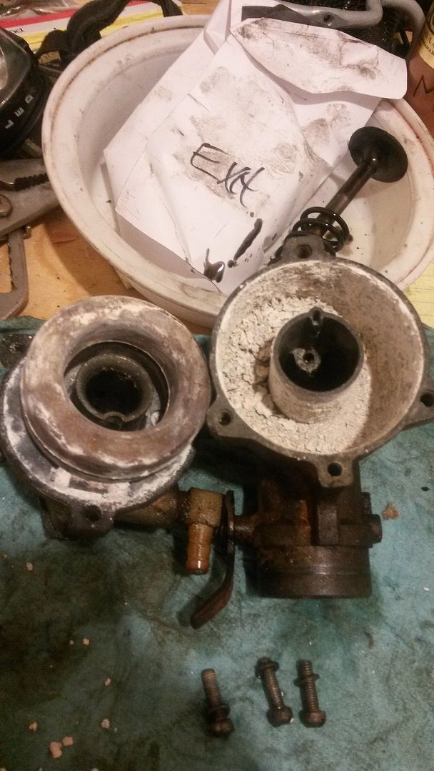

screw extractors have been as useless to me as teats on a bull...until now! I worked the emulsion tube out until the last stretch when it bound-up.
^^^ there's a new tube & jets in the rebuild kit already on order.
...and the contents of the float bowl didn't disappoint!

Ooofta - I thought the carbs I worked on were gunked up - not even! You got your work cut out on this one.....
