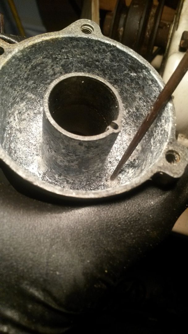

The 1st, this carb is shot...no surprises there.
^^ The tip of the ice-pick is where the fuel is drawn into the emulsion tube...packed solid with Alumina... fuggedaboudit!
I scored a used briggs replacement carb for $45...with the seller's guarantee.

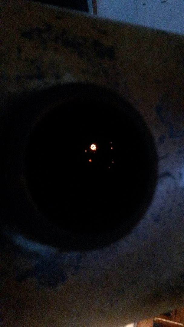

The second is to this fuel tank. The bottom is swiss cheese.
It's definitely salvageable however the cost of doing so approaches the cost of a brand-spankin' new tank.
If I were to proceed with salvaging, I'd do the following:
  • Remove the varnish with laquer thinner (temporarily plug the holes with bubble gum)
  • Remove the rust using electrolysis
  • POR15 degreaser
  • POR15 Metal Prep
  • POR15 external patch over the holes after sanding away the paint
  • POR15 tank sealer
Currently in it for $205. When all is said-and-done, I'll be in this machine about $250-$300. I can live with that. Thanks for stoppin' by!

FOR 75 bucks you can get a new plastic tank. and best of all it comes in black only.
Brutha-PS...the only plastic that will be on this machine...will be on the recoil handle...and now that I think about it, I'm going to swap that out with a fat chunk of old Iron

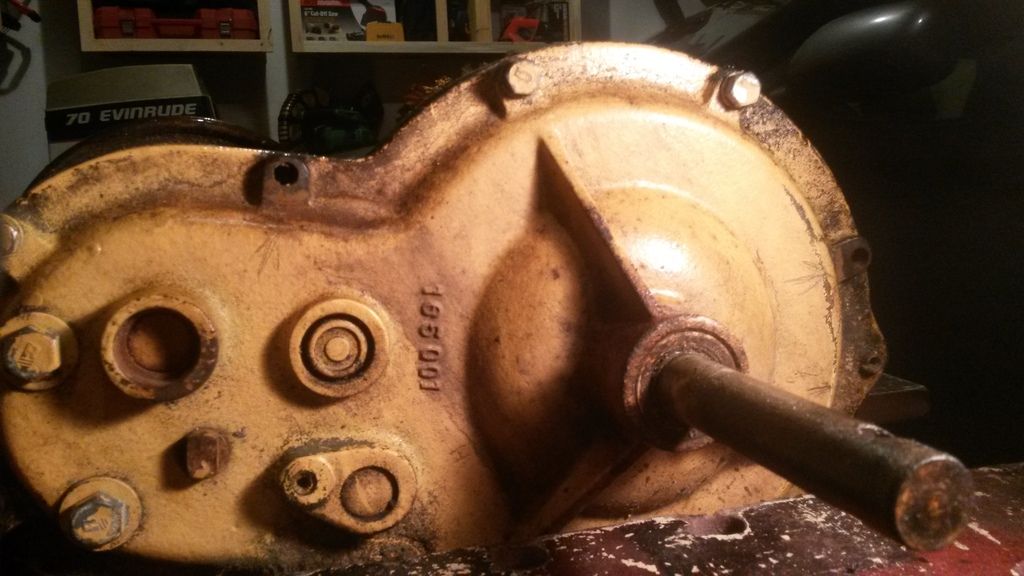

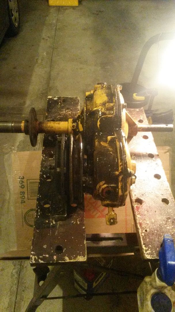

I got the transmission out of the machine...I bet it alone weighs close to 100#.
The good news is that I only had the chase the threads on one of the missing bolts...the missing upper bolt will need to be drilled-out / re-tapped.
I've decided to do it without cracking the transmission; I may get lucky with the left-handed bits where it walks out for me.
You guys who love old Iron will appreciate this: 1971 Popular Mechanics; see Page 16.
The debate at the time was friction wheel versus transmission!
I think this issue is fitting for the SBF archives...at the end, there's an article on how LED's will change the world!
