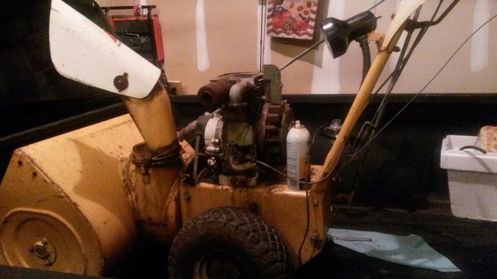

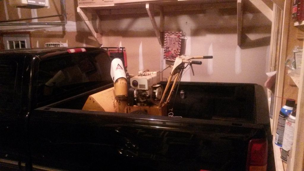

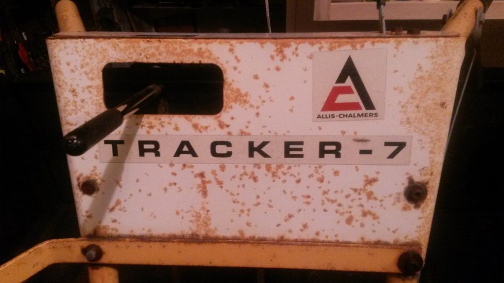

I couldn't wait until morning...
Ended-up paying $35.

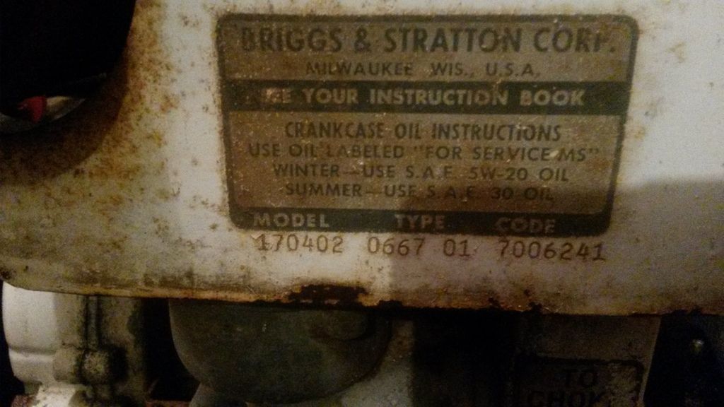

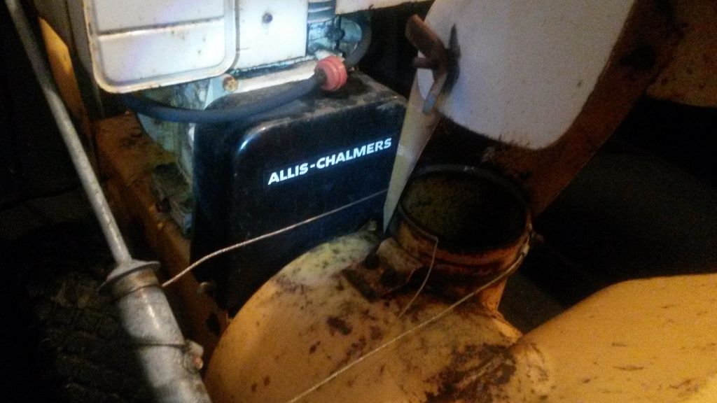

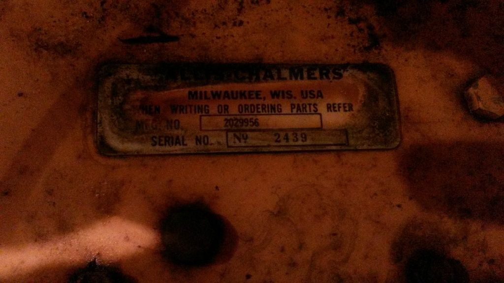

It's an Allis-Chalmers Tracker 7 (like raptor0192's).
1970 Briggs Flatty 170402 (I assume a 7Hp since it's a Tracker-7)
The machine has some surface rust...no rot that I can see.

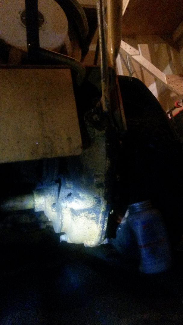

The transmissions on these things are massive! It's literally the size of the transfer case on my silverado.

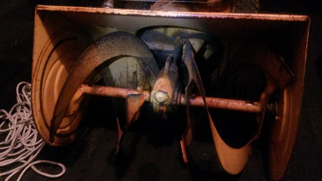

It has a 26" pie-hole:

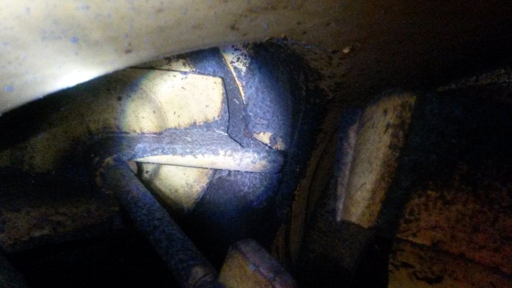

beefy auger gearcase:

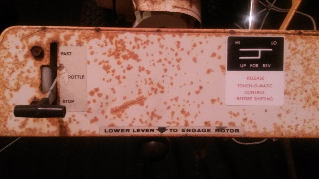

Even the belt cover is steel:

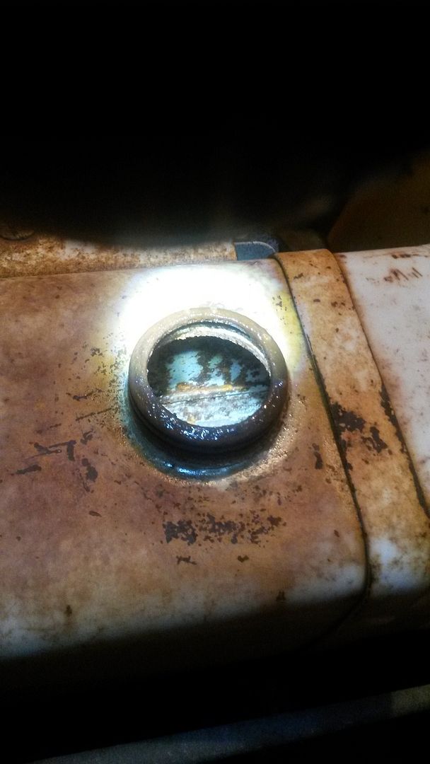

when buying an old-school briggs, the fuel tanks are always a concern...and this machine is no exception. Not sure if this beyond saving...

If you don't want to tumble it in sand and or pebbles and there isn't a hole in it you can always Kreem it. Kreem the inside, paint the outside and it's good as new.

Thanks Frog! I'll leak-test the fuel tank and give this stuff a whirl!

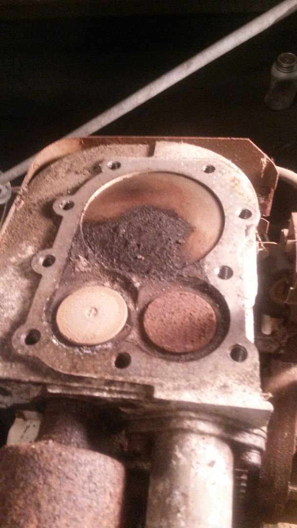

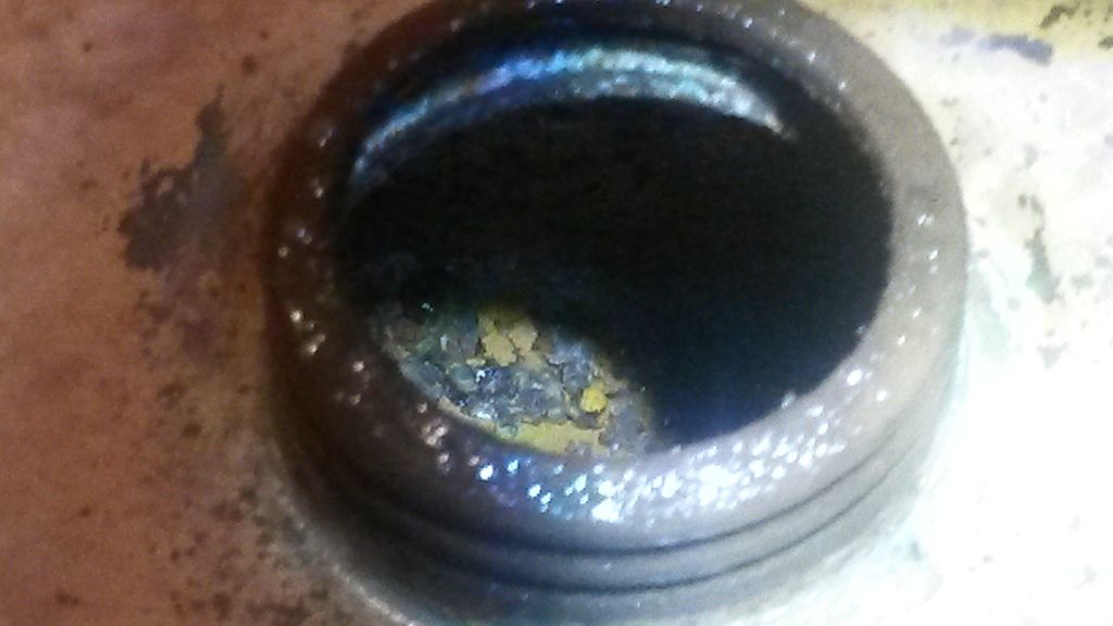

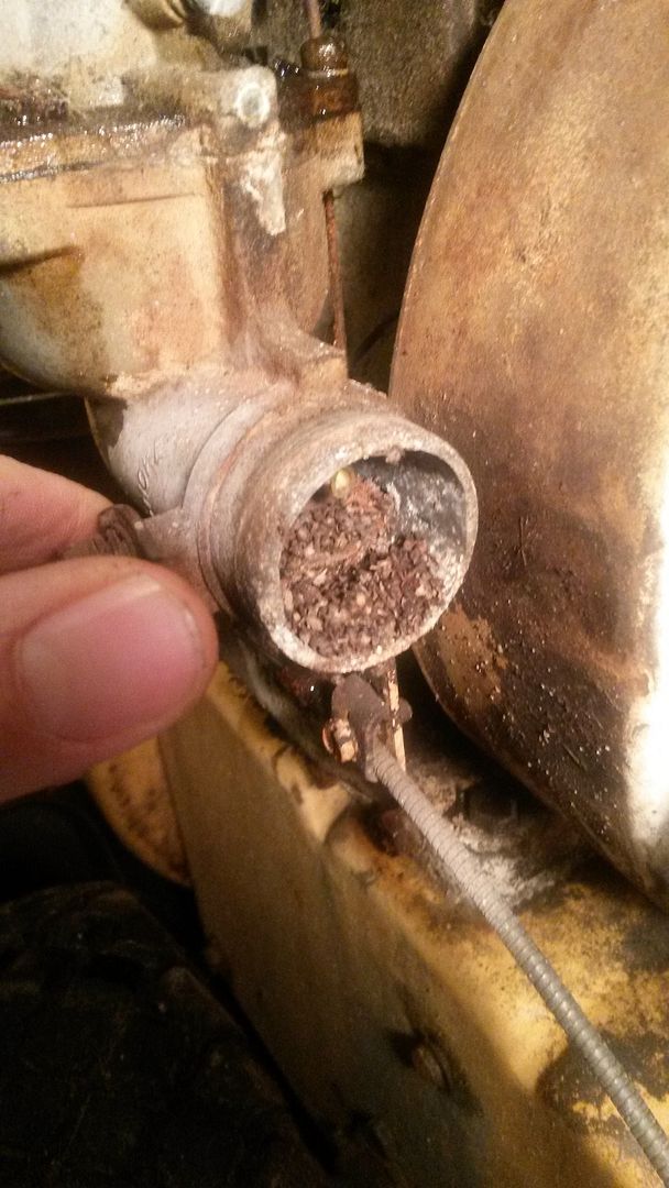

I've been wanting to tear into an old Briggs for a long time...
...and not soon after:
There was a pile of seed husks in the carb intake...
...which probably explains the burnt seeds on the piston
