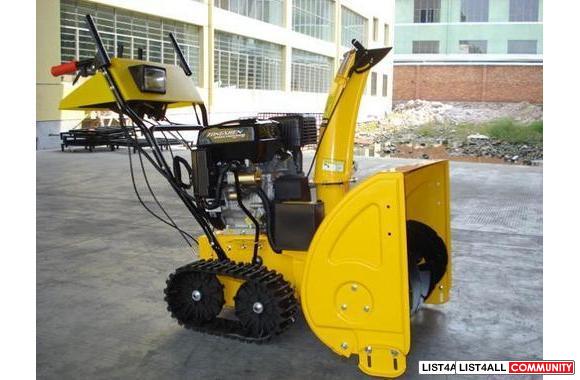

"Giovanni" Snow Blower is the brand
The model number starts with "gio". Theirs is a gio1101Q
One thing I just noticed under the "features" was:
"The Continuous-Variable Transmission (CVT) makes changing speeds quick and easy, with low maintenance."
That might be their idea of a friction drive but it might be something totally different. Need to see a photo of what's in there.

Definitely looks Chinese.
And looks like the drive speed control is via a cable. So if the cable broke or became disconnected, the speed would go to one extreme or the other... which matches the reported symptom.
