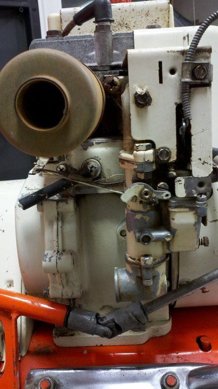

@motorhead64, Ray has pointed out that the carb on my machine appears to be from a 1960 or 1961 since it has the vertical intake setup which is different from a '62. To be honest, I'm not sure if mine is a '62 or '61. I was just going by what the seller told me. But looking at this pic of a '61 from Scot's webpage, it's starting to look more like a '61. Thoughts anyone?
Here is a close up of my carb.

Thanks for posting the pic ! That looks like my "updraft style" carb, a Tillotson E2B. I am looking at the governor arm to throttle connection.. is the rigid link on the lower butterfly hole? Also, is the spring in the same hole as the rigid link on the governor arm end? And lastly, what is the other end of the spring connected to? Is there a fitting of some sort on the blower housing with its own spring? Thanks again. MH

Hey Ken, what are the numbers on the engine? That should help nail down the year of manufacture.
