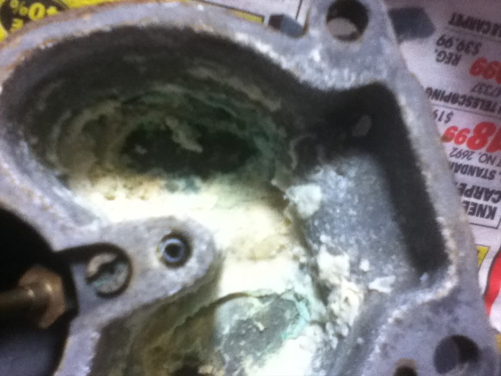

Here are images from a carb I took apart today. I had a no-start condition with a fuel overflow issue. I thought the float had failed but there was ( as there usually is) more to it.
apologies for the size but it's late and I'm beat.

That's some pretty yucky looking stuff! I have never seen that happen to anything I've used Sta-bil in myself.

I highly doubt that build up has anything to do with stabil..
looks like that stuff has been building up for many years..
there is something else going on there, probably unrelated to stabil.

You'd think wouldn't you? But, you'd be wrong. It sat from last fall. October? or so. Prior to that I'd rebuilt in in the spring (2011) so there's that to consider.
I'd put in Seafoam, ran the engine for more than 5 minutes, drained the tank, emptied the line and filter. Aparrently I missed the bowl? It's a small carb so there couldn't have been all that much in the body.
It's sat in the shed/tent all winter. Wood floor - not dirt.

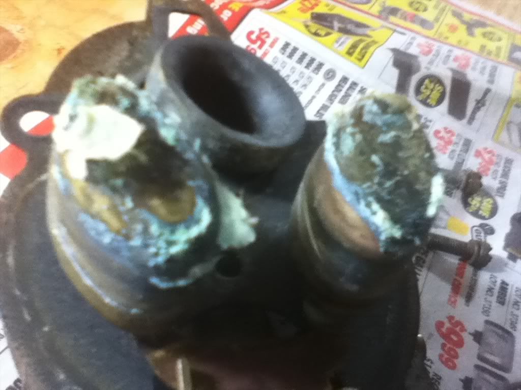

I used Seafoam as I've had other issues with Stabil - This picture is the carb off my SimpleCity Snowblower that sat for 3 seasons using Stabil. I followed the directions on the label and from the dealer and got this-
At the worst I overlooked the bowl but I don't think so and it shouldn't matter should it?
I wish I had the $$ to have a chemist look at this.
I've no problems with my Garden Tractor or my other 4 cycle stuff only the snow blower and this machine.
And yes, I'm good at following directions.
I also only use brand name Premium fuel.

That looks a lot like blended (Ethanol) gas has been run/sitting in it.

I have had terrible luck with stabil. I have recently been told there is another version that it better with the new gas ...but I am not willing to try.
That carb that marcintosh took a picture of looks like saw dust, I just took apart a carb that had that stuff in it when I took it apart...I was wondering what it was.
I am going to stick with my new method for keeping tanks and carbs clean.....tank off tank, empty it and dry it out. float carbs, remove bowl float valve and needle valves and blow carb cleaner then compressed air through. on the pain briggs carbs that are tank mounted remove tank and carb as one, take carb off tank, carb cleaner and compressed air through fuel pump and needle valve and empty and dry out tank.
