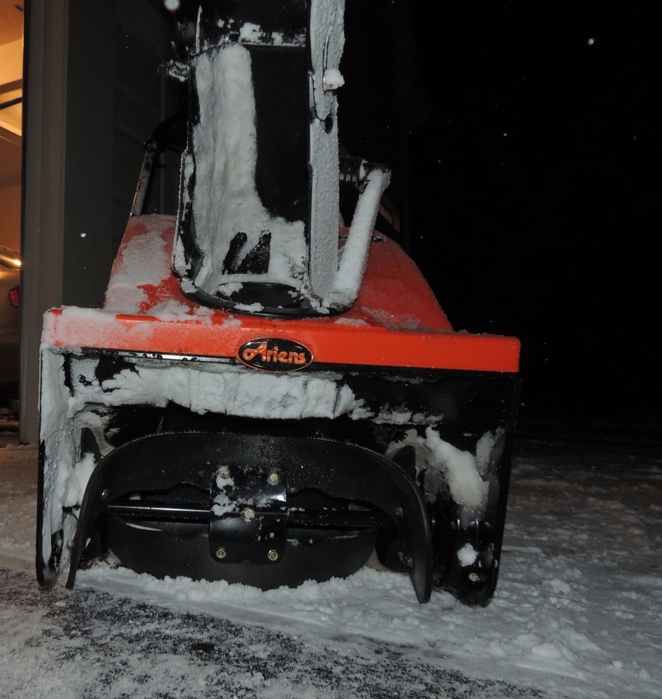

I've had this machine for a couple weeks and today was my first chance to try it. We only had about 3" of snow, but it needed to be cleaned up so it doens't ice over tonight and cause surprises in the morning.
The machine does an outstanding job of cleaning down to bare pavement - - see photo below. The engine starts on first pull and settles into smooth and fairly quiet operation. There is no throttle setting, it's just one speed. I can only compare this unit to my previous Toro CCR2000 machines and the Ariens feels heavier and it's not thrown around as easily as the small Toros, which I'll miss.
While we didn't have much snow, the unit has very good power, especially when it hits a heavy pile of snow - - this thing really throws the snow a distance. Appears to be quite a bit superior to the Toro in that regards.

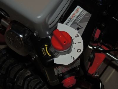

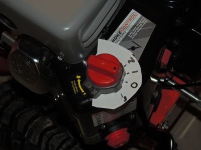

No, I'm not having any starting issues at all. This sucker fires up on first pull every time. Very simple. What I was asking about is the various settings on the choke. I've honestly never seen anything like it and both these new Ariens seem to be identical in terms of the rotary dial. 921030 pictured below since photographing is much easier :
I'm going to call Position 0 the run position or no choke.
I think Position 1 is half choke.
I think Position 2 and 3 are full choke.

yeah, I was just referring to using the choke in relation to starting and running. I still firmly believe you are running your engine on partial choke when you think it's fully off. 2 should be full choke and 3 should be choke 100% off.
I have two new Ariens and my buddy has a new Ariens (Compact 22) and all three of those are like I state. If yours will not run while on choke position 3 WHEN WARMED UP, then I believe the tuning is set too lean or you are at a higher elevation where the air is thinner.
If you would take a look at how the choke works, it would be almost impossible to make it work the way you state. The choke plate is directly linked to the knob.
You can also look in the manual, I'm sure it will tell you how the choke works and what the positions are.

Ok, so you're saying Position 3 (fully CW) is no choke and fully CCW, Position 2, is max choke. I'll got back and look again. I'm going to run the 921030 for the first time later this morning, JR.
When I got to Position 3 on the Path Pro, the engine immediately starts to die like it's running way too rich.

One of the two extremes should be choke off and the other will be full choke. Take a look in your manual, it should say which is which.
If it stumbles and the engine starts to smoke, it's too rich. If it stumbles with no smoke it's too lean. Both a rich and lean condition will cause it to stumble.

I assumed the owners manual would fully explain what the four choke positions are, and why they are numbered 3, 0, 1, 2, but sadly, it does not:
http://apache.ariens.com/manuals/04535800A_ENG.pdf
My guess:
Position 0 - partial "mostly closed" choke, the normal "start" position.
Position 1 - slightly more open, move here for a few seconds after starting.
Position 2 - then move here, Choke open, the normal "run" position.
Under normal circumstances, those should be the only three you use.
Position 3 - Full choke, should never need to use, but might need to occasionally, for starting.
The number sequence seems odd, but if I am correct, it might make sense:
3 - Full choke (lets say "100% choke")
0 - partial choke, mostly closed (start position) (lets say "75% choke")
1 - partial choke, mostly open, a little more open from position zero. (lets say "25% choke")
2 - choke open, "No choke" - the running/operating position. (lets say "0% choke")
(those percentages are just a guess..)
So normally you should go in sequence 0 to 1 to 2 when starting and operating,
and you shouldnt need to use position 3, but its there in case its needed.
Disclaimer..the above is a GUESS!
not having seen one of these machines in person, I have no idea if I am right or not.

I agree.
Although your guess is just mirror image of my guess...lol
I based my guess on the fact that he uses position 0 as "no choke" which I assumed is the closest to being choke off (1/4 choke). I wouldn't think it would run very good at 3/4 choke. This is why I guessed at position 3 being choke off as opposed to your guess of position 2.
