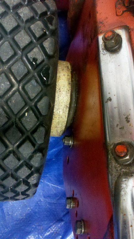

Well folks, I picked up a 1964 Ariens 10ML60D today. The owner had the machine 'tuned up' with new points/condenser, and plug at the start of the season. All was well until the previous storm. The starter would not engage the flywheel, and the recoil broke. Frustrated, the owner bought a new Craftman and kicked the Ariens to the curb for $20.
I fixed the flywheel ring gear, recoil, and started her up. She's running nice and smooth now after a few adjustment of the carb and linkages. The external impeller bearing is a bit crunchy, so I will address that next. Other than that, she's a sound machine.
The engine is a 1964. The bucket has the worm gear, so 1970-ish or newer. The tractor appears to be a 1964 as well, but I'm a bit surprised to see the long engine studs found on the 1960 and 1961 chassis to accommodate the thicker base of the H50 and H55 Lauson engines.
It seems to have a limited slip differential, allowing me to make easy direction changes just like my 1965. However, unlike my 1965, when I tried it in the snow, the differential locked up and delivered power to both tires.
