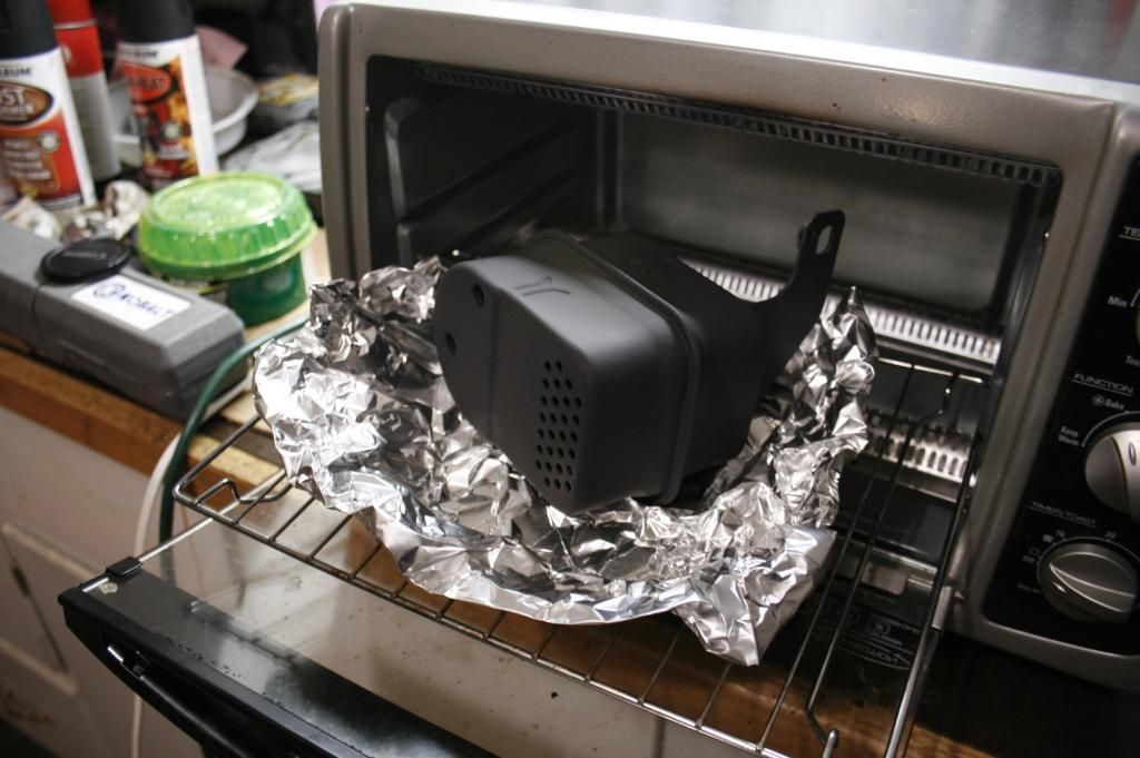

I bought a new muffler I believe from ebay and it didn't have the retainer...however it had the bolts; a trip to the nearest OPE shop had a used one.
Regarding the rust, I spray-bombed mine with rusto high-heat primer / paint & baked it in a toaster oven in my garage (to avoid my wife's wrath! ).
It smoked a little when I first fired it up but it still looks new after a couple of runs; paint didn't bubble off. I'll check-back in 10 years to see if it rusts from the inside-out
