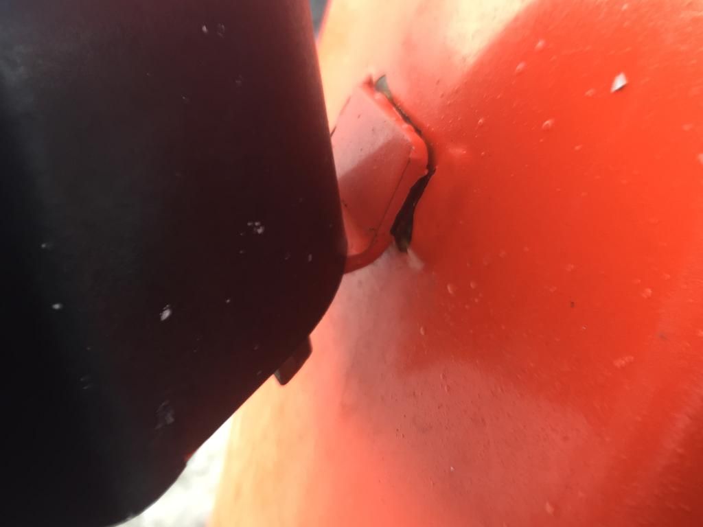

Today after another couple hours of use, a weld on the chute broke. The tab that connects the chute to the control.
The weld broke on one side, it was a bad weld, very little penetration. it was held on with another small weld on the other side, but if used the way it was, It would break completely and the chute would fall off. With more snow coming end of the week I thought I was in trouble.

That's what eased the pain a little, I was pretty upset that a 3 month old, $2000 snowblower was out of commission due to nothing more than someone doing a poor job welding the chutes.
You can clearly see the start of the weld not even touching the tab.

Uh oh. Looks like they got some over spray on that black cover.
It is great that they didn't leave you without a blower though.

Kudos to a real dealer that can actually fix and or fabricate what ever it takes to get it back to working.
The factory weld is unacceptable QC should have found that before paint.
When you get the new part just keep it. The repair might be better than the replacement.
