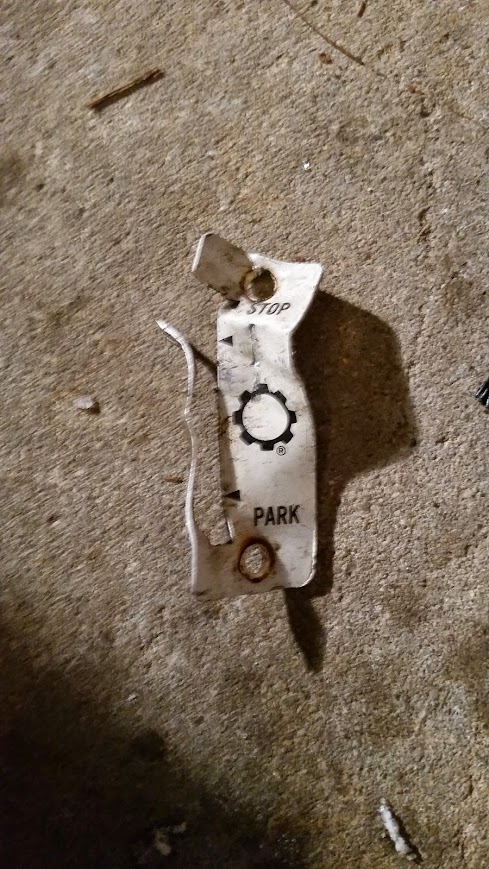

By drilling out the rivets that fasten the "fast-slow" cover of a 10000 series throttle lever, I was able to use it as a replacement on the 924040(I had to trim the plastic sheath by about 2 inches on the carburetor end of the cable:
It's not very pretty near the lever end but it works:
I found some screws that were the right size. They screwed in very tightly into the holes vacated by the rivets that I don't need nuts to hold them in place

clever mod on the throttle plate. have you tried to start her?
