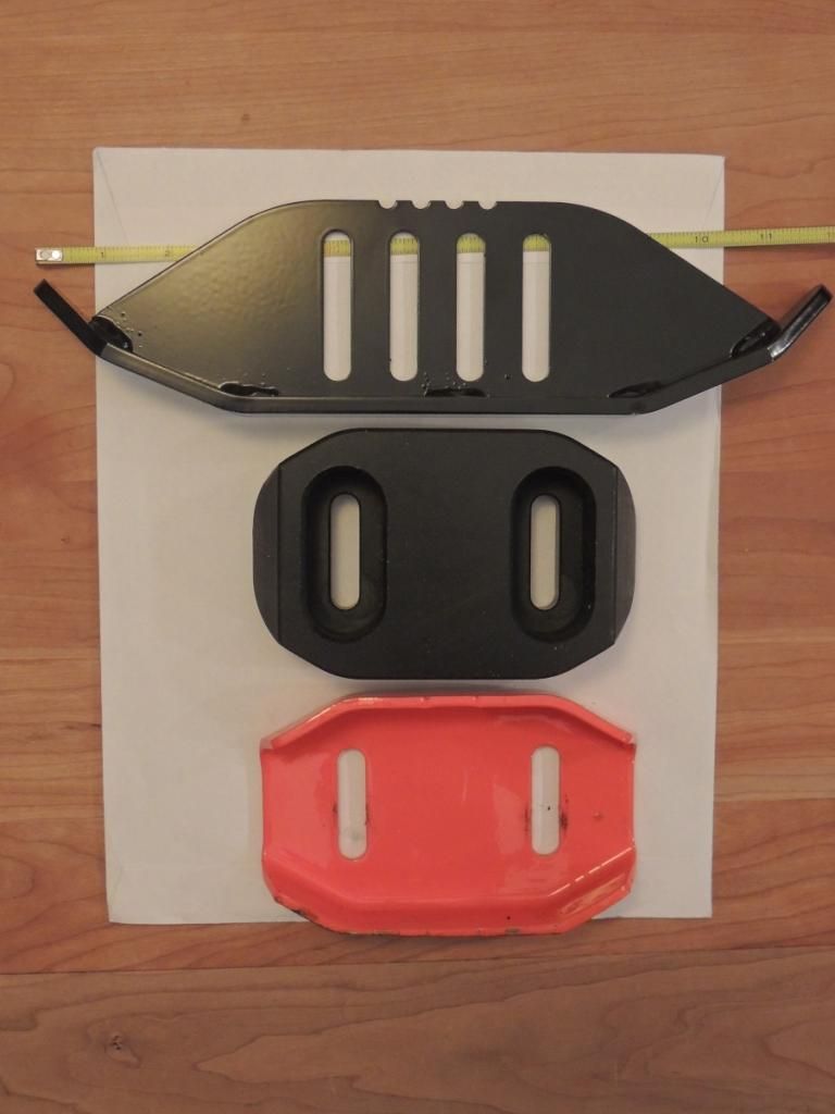

Barros, Armor Skid (top) compared to the Ariens parts:
uberT is online now

The model I used for both my compact 22 and my deluxe 28 is ASC0310-B.
The one thing that I haven't seen anyone mention about the Armor skids is how they protect the bucket edges. On my Compact 22 there is not a dent or scratch on the bucket edges.
On my 28 I used large washers to compensate for the roll in the metal, but they sell the spacers made for the Armor skids.
SnowBlowerSkids they are at the bottom of the page at this link.
3 inch slot spacing
podevil is offline
