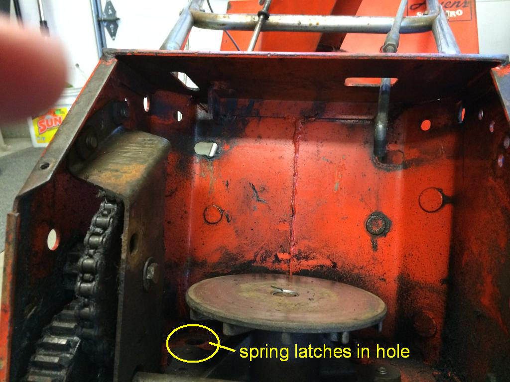

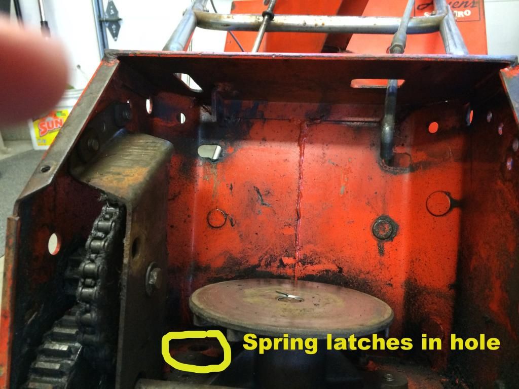

thanks for the fast replies. I got the unit out and the friction disk replace. However, when I was taking it out, i did not pay attention to how the spring is attached. can someone direct me where the spring hooks on to?

I took a look at one of my other machines and figured out where the spring latches to. A bit more work than I expected, but she's all buttoned up and as good as new.
