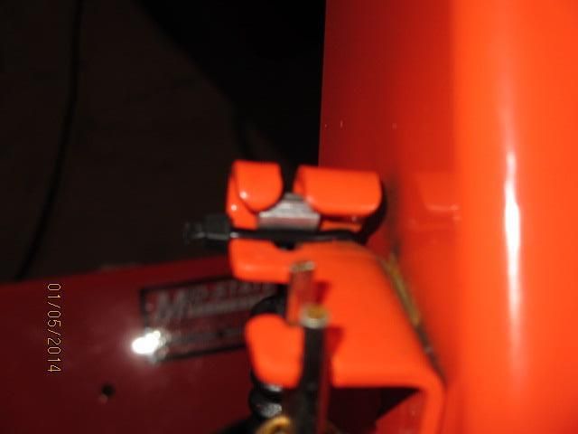

I just bought the 921030 about a week ago from a local dealer and mine had the grease pencil marks on it also. I thought the same thing that they did the marks during setup but after reading here a few more came that way it appears that's done at the factory during assembly . mine came with oil in it but I'm guessing that was done at the factory also because both units I checked had the oil level the same, about 1/3 up from add to full. I had them fill it to the top level before I took it home. upon inspection I questioned how good a job they did setting the machine up. I thought my traction cable was too loose and the auger drive cable pretty close. I adjusted them to engage at the same height off the bars. after removing the slack out of the deflector cable I zip tied the cable just under the barrel so it would lay right under the two tabs on the deflector to keep it in place. mine wanted to rest exactly 90 degrees from the tabs and inline with the slot to attach it. also did anyone have the top of the rubber deflector cable boot ziptied to the cable. I don't think the factory set them up that way? anyone verify that on there machine? mine was! the boot was not pushed down over the cable sheath but held tight to the cable so as you ran the deflector the cable would become bare under the rubber boot exposing approx. 3" of the cable end to moisture. another thing I did was open the gap between the sides of the deflector and the chute so it wouldn't rub the paint off working the deflector up and down. also lubed the deflector hinge, nylon gear plate and steel gear under chute rotation cover, the steel pin to chassis hole under the deflector spring, the chute to blower housing rotation, the axle drive bushing on each side, the scraper bar adjusted to 3/16" ground clearance, and about 30 pumps of grease into the 2 auger shaft zerks. I then opened the rear cover to verify that the gears were greased and it appears every thing was greased and oiled per the maintenance chart. all six bolts have to be removed to remove the rear bottom cover, I was hoping I could just remove the back two bolts and loosen the side four and the cover would just slide up and off. at close to 10 hours I will change oil per the manual but am on the fence whether to use synthetic or not. the traction lock on my machine seems to be working correctly and haven't experienced any problems or dislikes so far. not fond of the gas tank and screen , nor the combination choke and throttle comtrol, but i'll get used to them. here's a pic of how I secured the top deflector cable grommet in place.
