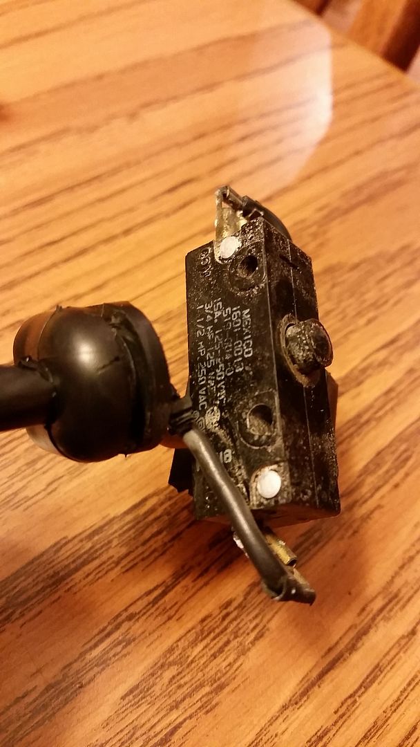

post #10 of 15 Old 09-27-2015, 10:28 AM Thread Starter
Join Date: Sep 2015
Posts: 15
This is the faulty switch. The rubber piece that you press just sits on top of the button like a hat.
