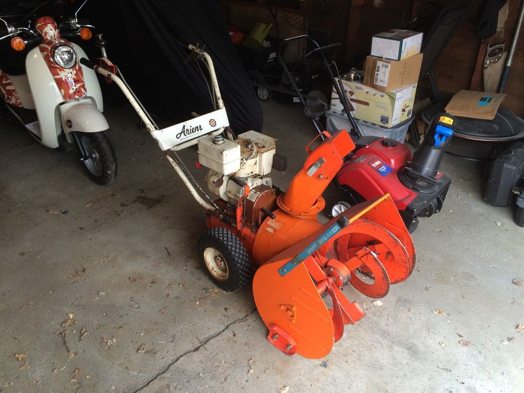

Hello!
I'm brand new to this forum and am hoping to get some general advice on an Ariens 10m5 (1966 model I believe) that I recently acquired from a neighbor for a measly $100.
Before I get to my questions, I should say that the unit seems to be complete and works great. All I've done so far is replace the spark plug and engine oil and filled up the tank with fresh non-ethanol gas. She starts right up on the first or second pull and the thrower mechanism appears to function just fine. Having said that, there isn't any snow on the ground here in MN 'yet' so, I still haven't been able to give it a proper test.
I also have a new set of Snow Hog tires coming from Northern Tool because the ones currently on the unit are pretty sad.
This is my first 'vintage' snow blower as well as my first two-stage so I'm in unfamiliar territory. However, I consider myself a reasonably handy person with the right manuals and tools and have done fairly extensive work on various motorcycles over the years.
At this point, the questions I have all boil down to...
What do I need to do right now to ensure that this nearly 50-year-old blower is rock-solid and ready for whatever Mother Nature might throw at it this winter?
Eventually, I would love to put a little money into this unit and perform a full restoration but that's probably a project for next Summer at the earliest. For now, I just want to know that it's not going to fail me come January and February.
Thank you for any advice you are able to provide.
-Brian C.

better stick some new belts on it. check the auger gear case to see if there is lube in there. tighten every bolt. . set the scraper blade. grease every thing up. grease the snot out of the axles. put winter air in the tires . ALOHA from the paradise city.

and get some proper shear pins !!!

Welcome to the forum, Ok so for now you have a very nice workable unit but as mentioned in the previous post some verification and adding grease is in order: 1- remove the wheels to see if they're not seized on the axle and check if they are well greased.
2- remove the shear pins on both augers each side and you should be able to turn them freely if yes on both point 1 and 2 that means they were greased and you should thank the previous owner.
If not well on both points it doesn't stop you from using the unit but you will have to address these before you hit something with the auger and might destroy your gear case.
3-as mentioned by PowerShift verify your oil level on your gear case.
Please report back on those important issues and you can ask Shryp as he has much experience with this model.
Good Luck

Looks like a great low hours blower.
Plus 2 for what has been advised. I'm not sure what tire size will replace those, any thing tire with a larger diameter will change the the wheel speed, and trust me first gear is not slow enough.

Plus 3 with everthing that's been said. I would also take a look inside the main body to look at the friction disc that drives the wheels, and clean off all the shafts in there that things lide on. Then put a very light film of grease on those shapts and gears/chains.
Don't get any of that slippery grease on the drive disc plate or the drive disc. I would use some brake cleaner to spray on the shafts to dissolve the grease, and then wipe it all clean.

Thank you very much for the replies! This is exactly the sort of info I was looking for.
Hopefully I'll get a chance to dig into it in the next day or two and I'll report back.
