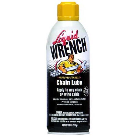

For chain lubrication, engine oil, or actual chain lube (any brand) if you already have some for a motorcycle or ...
But follow Normex's warning of not getting any on the friction drive parts !!
