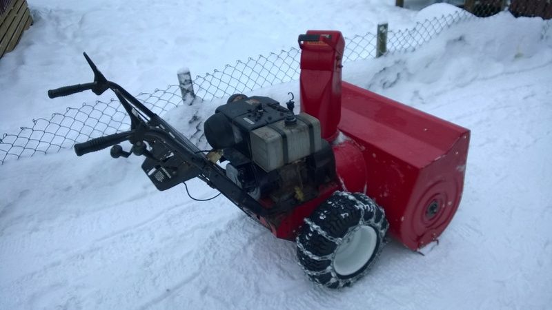

I bought a ST1032 for some days ago. And I dont know so much about this type.

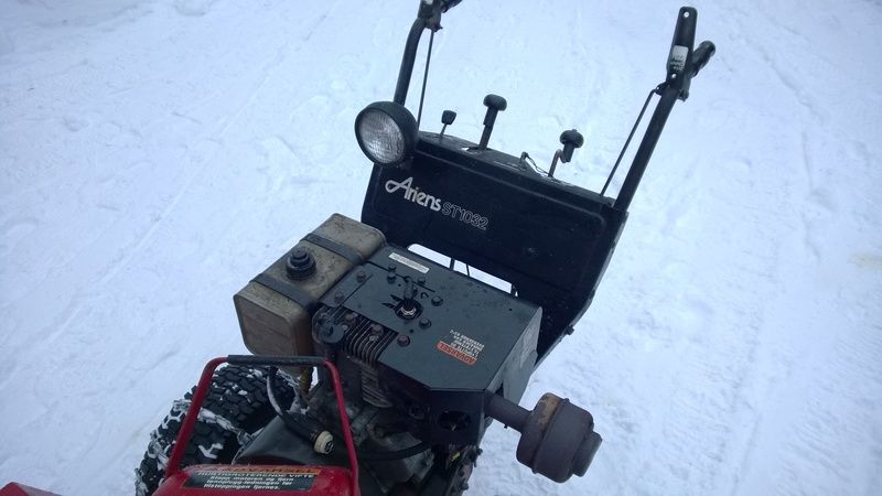

It is really hard to start on cold motor, but when I get it running it runs fine.
It backfires a bit when I adjusts down the throttle.
There is a hose from the valve cover to the carb that got som cracks. What is the function to this hose?

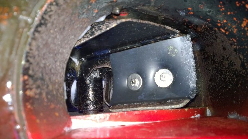

And it dont throw the snow so far away, just a few meters. I`ve put on a home made impeller kit, and it did help a bit.
Any tips for some of this?
It have been repainted of a previous owner, but maybe someone can se what year model this is?

Anyone who knows the function to this hose from the valve cover to the carb?
It is very bad
Ariens10 is offline
post #7 of 11 Old 01-16-2016, 05:29 PM
that hose is a breather tube, it helps to recycle crankcase gases that were unburnt to be reburnt. i really wouldnt worry about it
