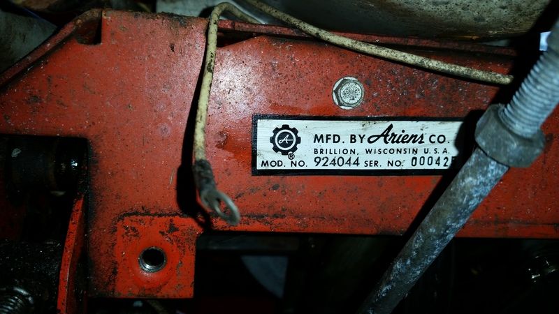

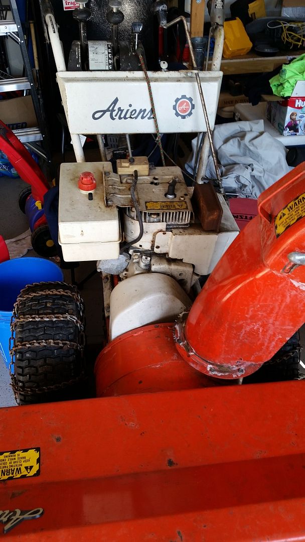

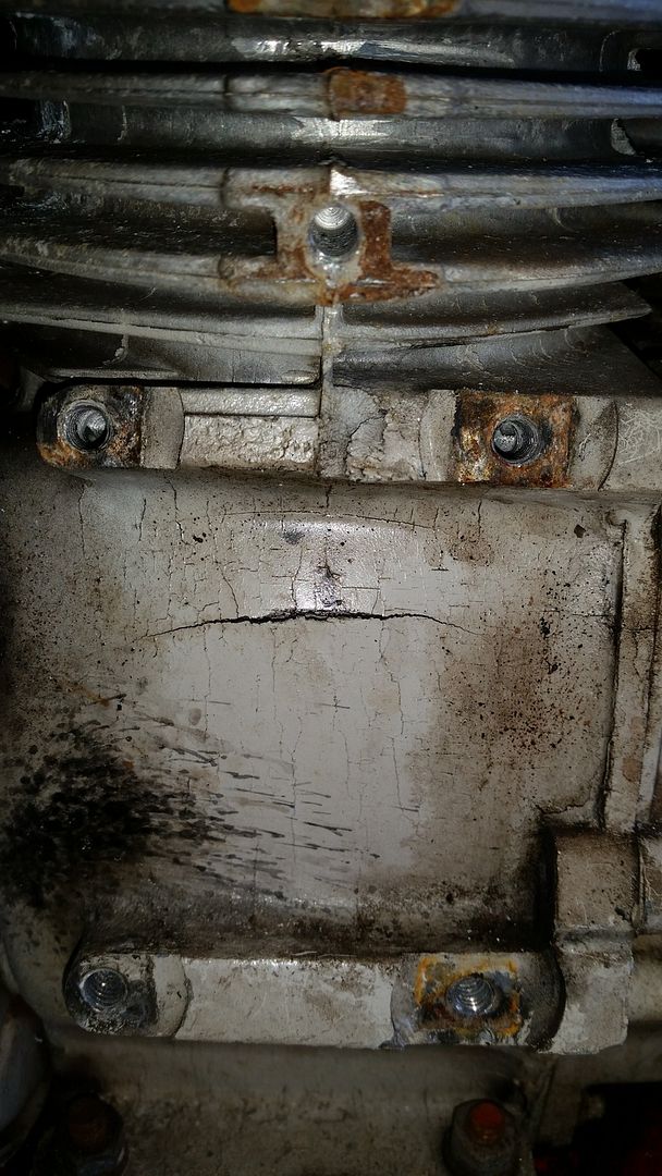

I came across this amazing site after doing some research on this particular machine that I just took possession of. It used to be my grandfather's, which was then passed to my dad, and now has made it's way to me. It hasn't been run in a few years, so I decided to break it down a little to see what all I could find. Unfortunately, when I took the starter off, I noticed what appears to be a crack in the block. I'm guessing that it threw a rod at some point?
I'm totally bummed as I was originally hoping to throw a new carb on, change the oil, grease the fittings, and get it back to running again. But now it looks like that's not going to happen.
What are my choices as far as a replacement engine goes? Do I need to find an original one or are there direct bolt on aftermarket ones available?
Also looks like I'll need a new friction wheel.
Here are a few pics

That does look like a thrown rod.
I would say look at the 301cc or 420cc Predators at Harbor Freight. If you had the 24" model then the 212cc would work fine. Also looks like you are correct about the friction disc. You other option is keep an eye on your local craigslist for someone selling a junker with a decent engine.

Most likely they will be a direct fit. Your only issue is likely to be you will need to bend the chute crank bracket slightly to fit around the OHV design. The other thing you will need is new bolts for the front of the engine. That will probably be 1 bolt for the crankshaft and 2 for the belt guide. The threads in the front of the new engine will be different.
You could also look around for a Briggs or Tecumseh of similar size.

From the muffler shape, I'm speculating it might be the 7hp Tecumseh? These older Ariens are fairly common around here, though yours looks like it's in nice shape. If it was appealing, you might be able to find one inexpensively with a blown auger gearbox, etc, then swap the engines.
Repowering it with a Predator engine, or similar, could be a fun project, of course, and newer engines have their benefits. You would likely need to remove the air cleaner from the new engine, and maybe make a shroud to use exhaust heat to keep the carb warm.

That is an 10hp Engine with a 1" crank. The 8hp predator would be an easy swap. It would mount in the same spot as the original engine, and the Original Engine pulley would fit as well. There are no chute crank modifications needed. Here's a pic of a newer but somewhat similar machine with a 6.5 predator conversion. Friction wheel is an easy fix on that model!
