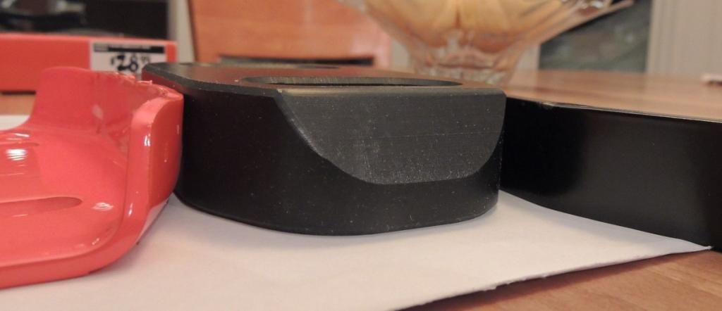

OE v. poly v. ARMORskids:

Tom, I've used the Ariens stock & Poly Skids, as well as ArmorSkids
(both styles) on my Platinum 24 SHO and found the stock skids "grabby."
For general use the Poly Skids are a good choice for the AutoTurn but the
ArmorSkids are the way to go if you have to deal with rough, uneven, surfaces.
My first set of ArmorSkids (wide profile on both ends) did want to climb drifts
but I have a good feeling that the new design (narrow profile on one end) will
resolve this issue. While its still too soon to tell, the drifts I have dealt
with using the new profile ArmorSkids posed no problems whatsoever.
What I really like about the ArmorSkids are the length. They allow the scraper
bar to clear many rough areas , whereas the Poly Skids would allow the scraper
bar to drop down, and hit, once they (Poly Skids) made it past the rough spot.
Bottom line, the Poly & ArmorSkids perform pretty much the same as
far as the AutoTurn is concerned if only dealing with smooth surfaces.
Edited to add:
Below you will see the "new profile" ArmorSkids,
which have the narrow profile (on the left.)
There is actually some dirt on the skid in this photo from
when I was working the "step up" at the edge of our drive.
