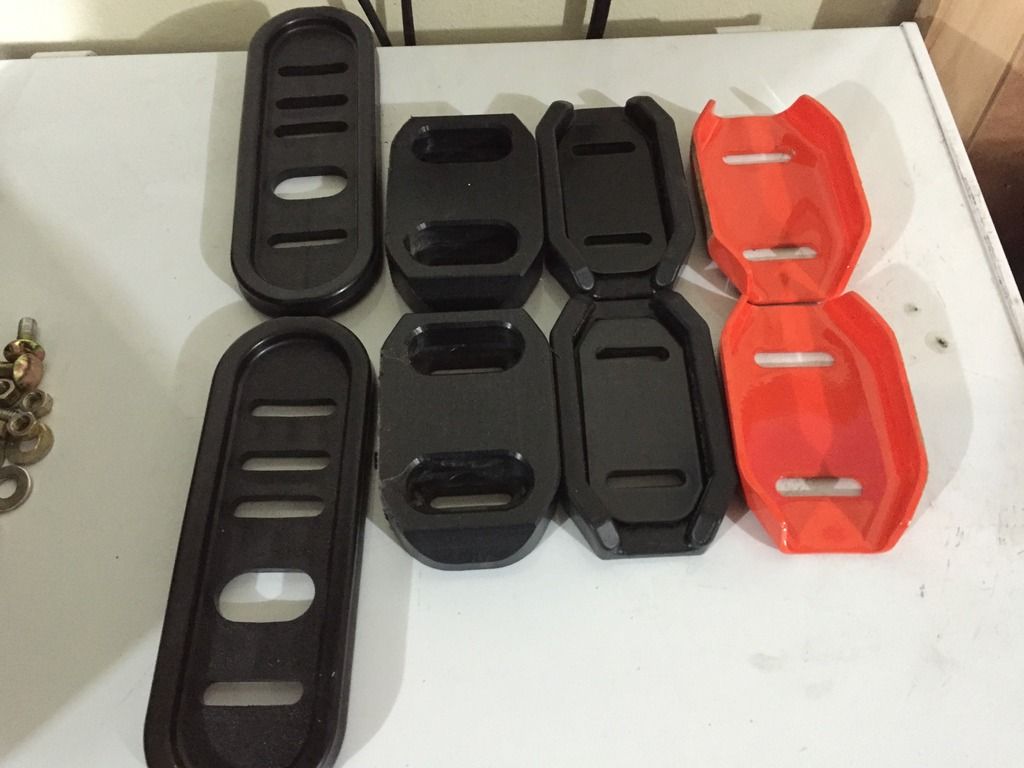

The skids from left to right...Arnold's Universal Poly, Ariens Poly, Toro Poly, and Ariens steel.

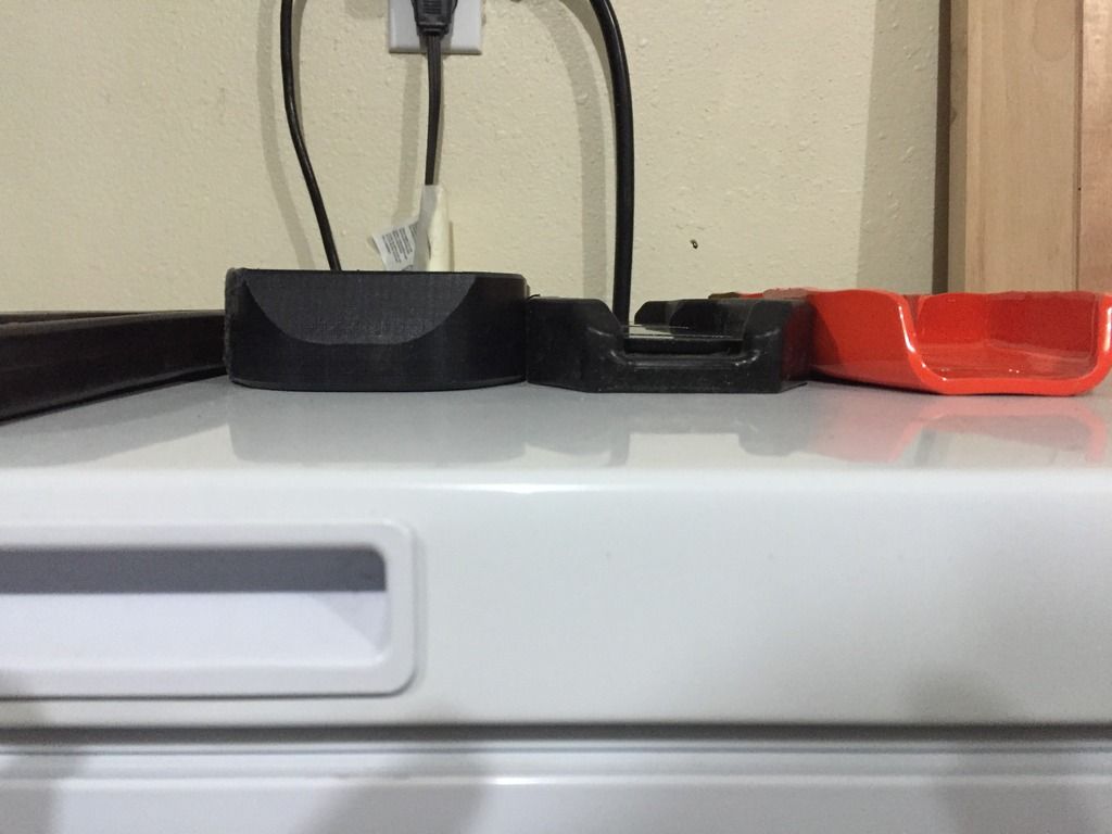

All of the Poly skids perform really nice in fresh snow. With hardened crusty snow and firm to hard drifts the Ariens Poly skids act like door stops. The Arnold's will ride up but are the thinnest and behave a lot like ArmorSkids would. Here are the thickness differences. The Toro are the closest to the stock steel skids and they get through the hardened snow just like the steel skids will.

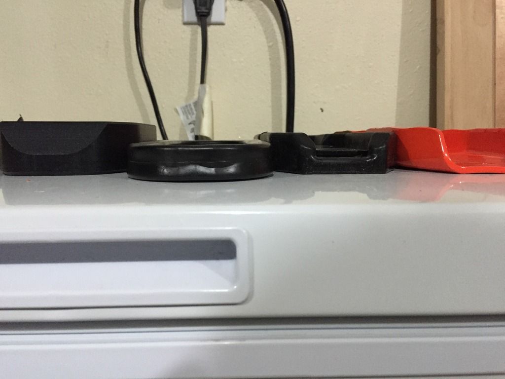

Different order in the lineup of skids...

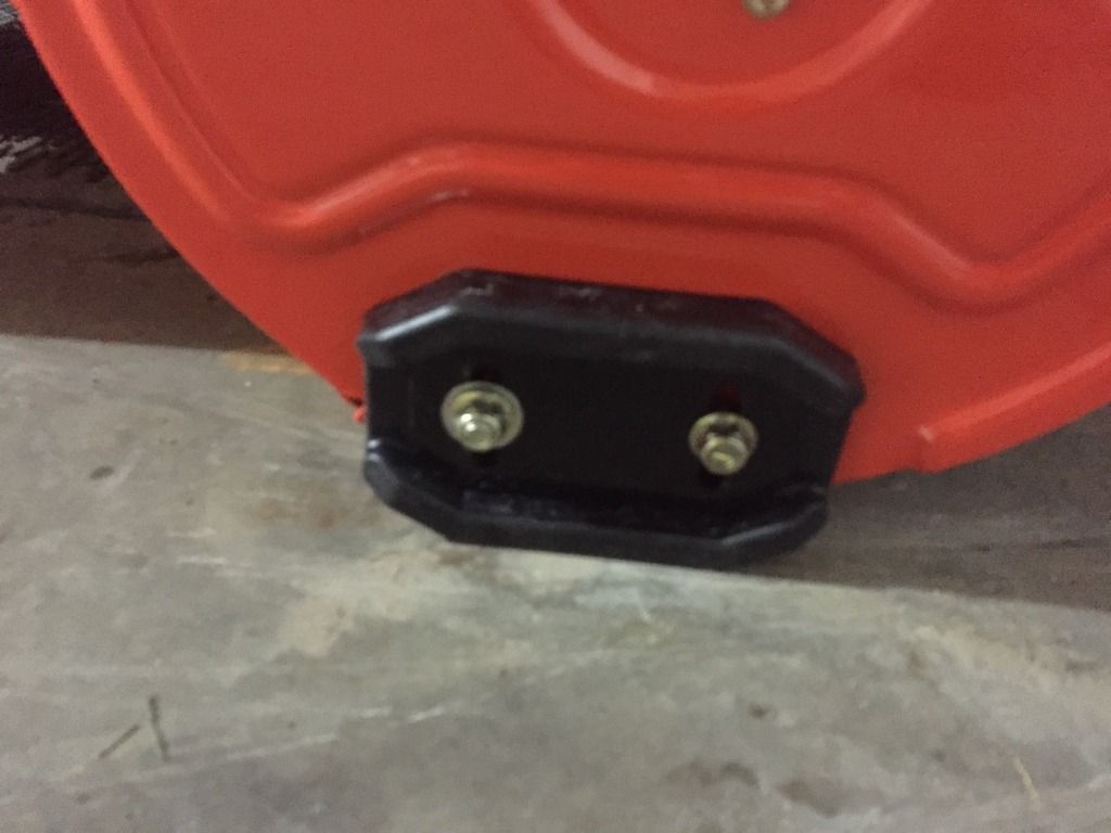

The Toros come with 5/16" hardware and are designed to be used with it. So I had to open up the slots a bit (a little bit over a 1/16" on each side) with files on the outer edges in order for the Ariens 3/8" hardware to work. I used wood rasp files on the poly and metal files on the steel reinforcement mounting plate. To mount the Toros I used the shorter Ariens steel skid bolt in the front and the longer Ariens poly skid bolt in the back.
Here's a pic of them mounted on the bucket...
