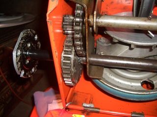

The other thing that I noticed was... that the sprocket above the differential assembly moves/slides about 1/8". Should it? I do not see any kind of pin that is supposed to keep them from sliding. In the parts manual I see two bushings in the illustration, but it looks a bit different than how my machine is set up. The 2" bolt that holds it in place seems like it can be taken out pretty easily, but before I even start anything, I'd figure I'd post this and ask.

Does anyone know if that top left gear and the sprocket to the right with the chain it is supposed to have any side to side movement? I am getting about 1/8" (strong) of side to side movement. I did notice about 4 light rub marks on the right side of the differential gear which I would guess was caused by the chain. I am not getting any up and down movement, just side to side.
yes .there should be some play side to side. 1/8 " or so is about right.

Just an update. The bushings are in and I left the sprocket gear alone. I did how ever... add a thin spacer to the right side of the shaft. It filled in the slop okay. I think just enough. It is all back together now. A little touch up in the impeller area and I will be all set for the winter season. Hopefully I will not have to use her.
