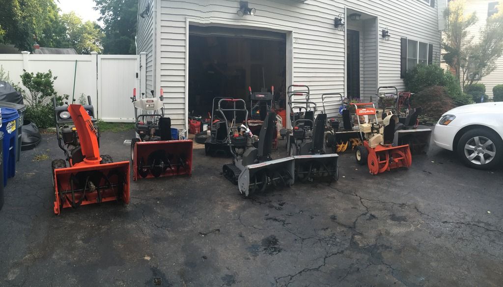

Thank you, I will double check the model number. I apologize, I thought 1128 would be the number. As you can see I have severely upgraded! Can't wait till see this throw snow with the impeller mod!
Cable adjustment for the shift lever, correct?
