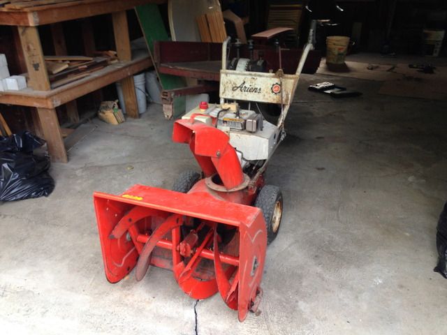

Well my patience finally paid off. I've been trying to find a 924039 machine in good condition at a reasonable price, and I just found one that has been stored in a barn for years by its original owner:
I brought it home for $90. The original 8hp tecumseh runs, albeit only on 3/4 to full choke. I've already pulled off the carb and will do a cleaning or rebuild. The augers do not appear to be frozen on the shafts and the augers/impeller move freely. I even got the original owner's manual.

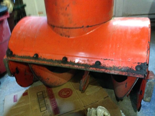

Rust is minimal for its age. The worst of it is at the bottom of the bucket by the scraper bar:
Having procured this, I wanted to run a few questions by the brain trust here to help me plan ahead. I want this to be my long term machine, as it has the right combo of what I am looking for (8hp, electric start, automotive style differential, controls all up top, old school thick steel).
1) I'm on the fence over a full blown strip/repaint. How bad is the rust on the bottom at the edges of the scraper bar? Should I be concerned about it rotting through soon?

The rust at the bottom of the auger housing does not look bad at all and I do not think that it will rot soon but you could clean it and prime it at minimum to stop it. (if it was me, and it was my dream machine I'll get it powder coated.... )

I'd agree with hsblowersfan, the rust on the rest of it doesn't look bad. Depending on how far you want to go with it, it looks like it should clean up nicely for you.
