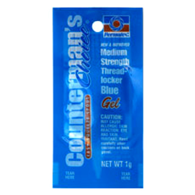

Be careful not to over tighten the mounting bolts as the aluminum mounts can break or strip pretty easy. Good place to use a little thread locker. If you don't have any on hand most auto parts stores sell a single use packet for a buck or buck fifty that will easily be enough for the four mounts and it's cheap insurance.
