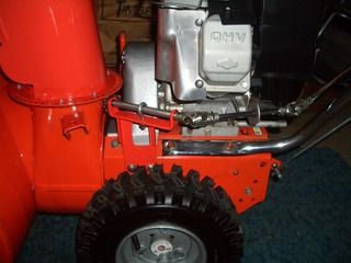

Or... do what I did. I converted my 1971 over to the older sprocket style. I had the sprocket style ring put on a tall chute. It will help to make the clearing job that much easier. (Three and three/quarter turns from side to side.) Which is something like from 8 to 4 o'clock.

Gee... Scot, I wonder why mine takes 3 3/4 turns, to your 2 1/2?
