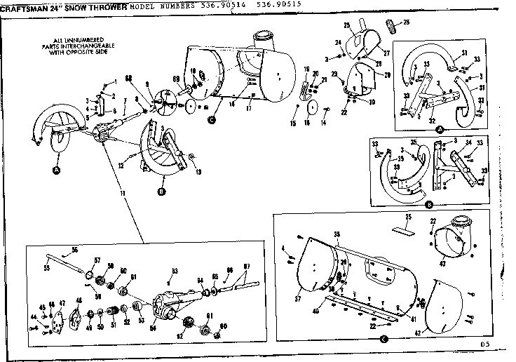

Ok so I just inherited a very old and somwhat tired Sears 536.90515.
I runs ok but is in need of some repair with the major problem being the wormgear box running the main rotating blades.
I'v e gone to the Sears parts site and found that parts are no longer available for that part of the unit.
Can nayone direct me to either replacemnt parts or substutions for parts for this thrower?

Post a Photo of the Auger Gearbox. Pics Help.

Link to Sears: AUGER HOUSING ASSEMBLY Diagram & Parts List for Model 53690515 Craftsman-Parts Snow-Removal-Equipment-Parts | SearsPartsDirect
My cheat sheet says it might be made by one of these:
536 amf
536 noma
536 western tool & stamping
Likes bwdbrn1 liked this post

I should have what you need. That looks like a stub shaft gearbox from an old Driftbreaker. I have one here and the gear, worm gear, gearcase, and auger shaft all match your model's part numbers. Looks like the impeller shaft MAY be different. PM me.
