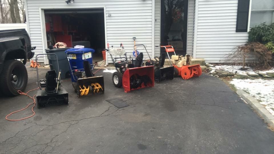

Next week I will line them up. Where should I post the photo. Here is an old photo.
I either found them at all at the curb except the Big Red Craftman. Paid $100 for it. Needed an auger shaft, worm gear and a tune-up. Made me good money in the past snow storm. That is what really started the addiction. My pride and joy is an Ariens 1128 that I picked up for $125 and it needed a float. I can't get it to go in reverse with it on the ground. I take weight off wheels and the tires spin. That will be a post for another day.
There are some Ariens aficionados here that can help guide you in the right direction with that issue.
The Craftsman that you are picking up, works a lot like that Bolens you have in the pic, with the vertical engine. They really work well at cleaning up for lighter snowfalls.

Cool pics, those of us with "the disorder" love this kind of thing.
What's up with the Ariens? Couple pics might send you on the correct way like db said
