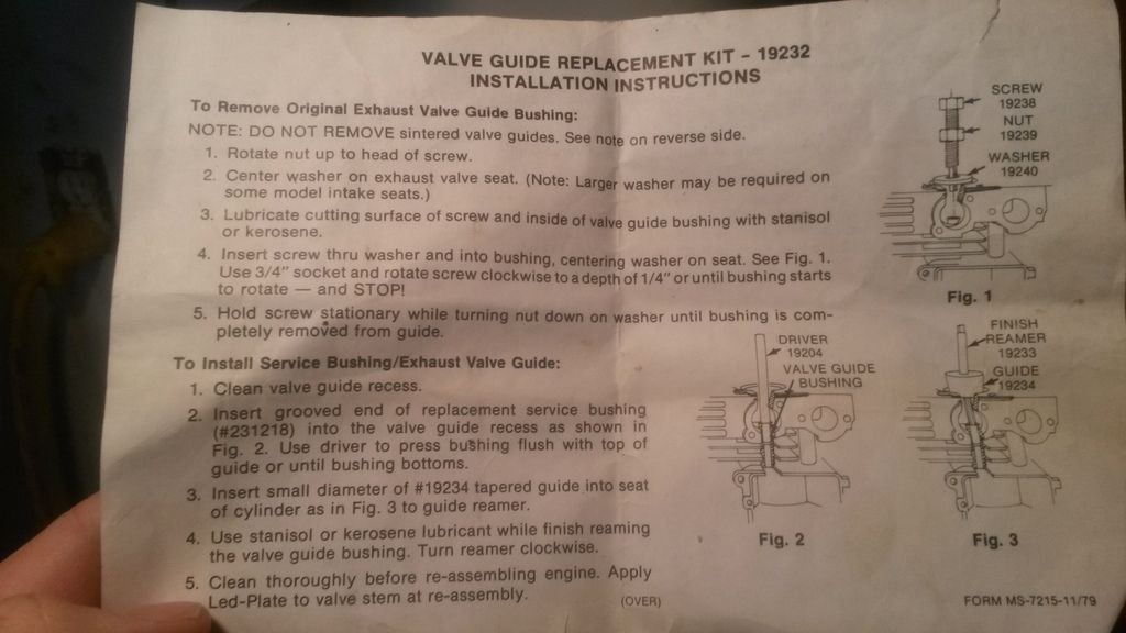

Briggs Valve Guide Puller
For those of you with an old Briggs with loose 5/16 valve guides (not 1/4 valve guides).
here's a 19238 puller and it looks like the one with the integrated tap.
you would still need to find a few more components (reamer, driver, washer/nut...although the washer/nut can probably come from a hardware store).
