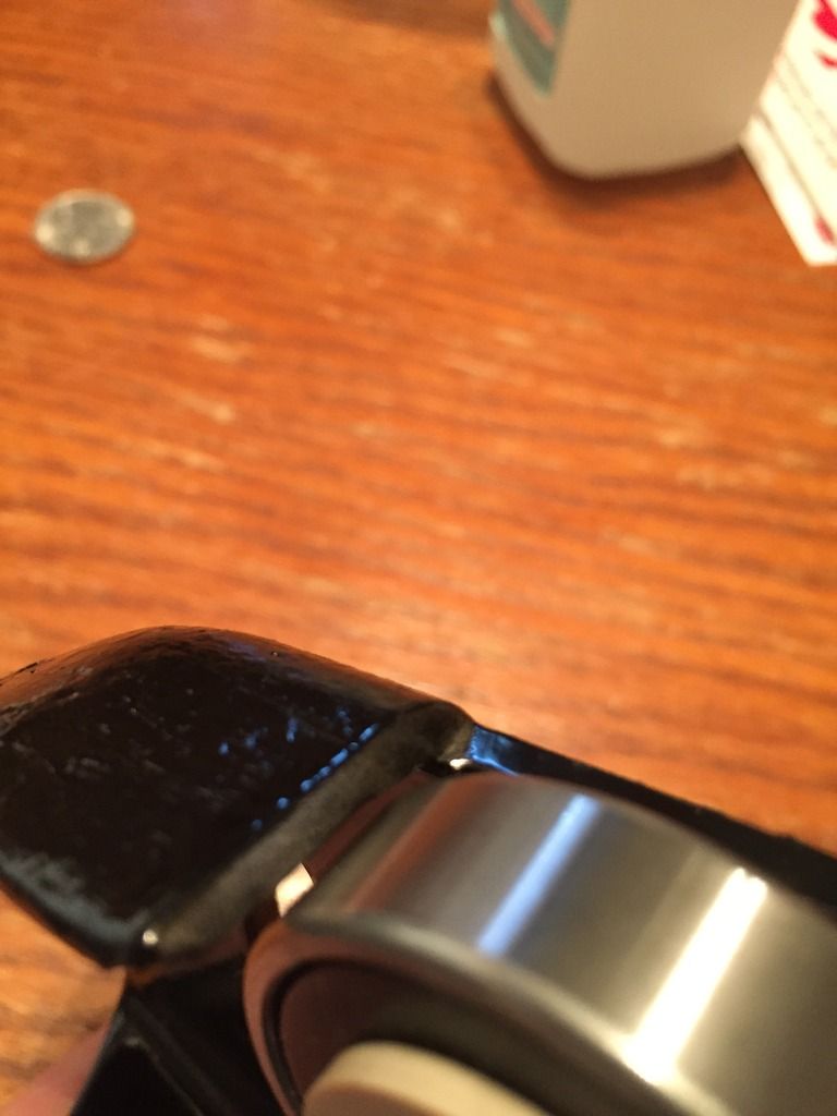

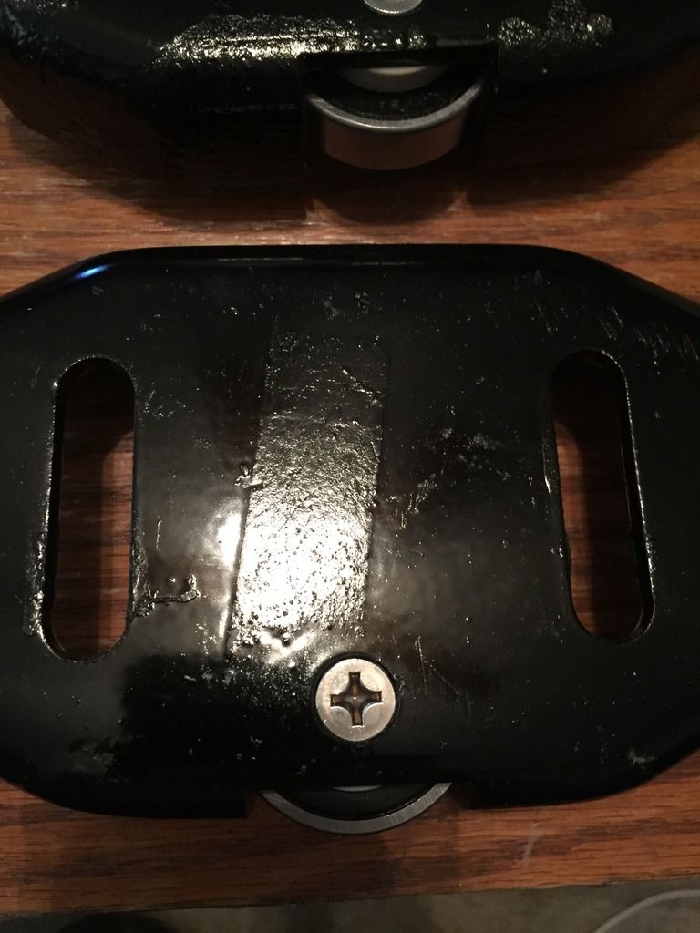

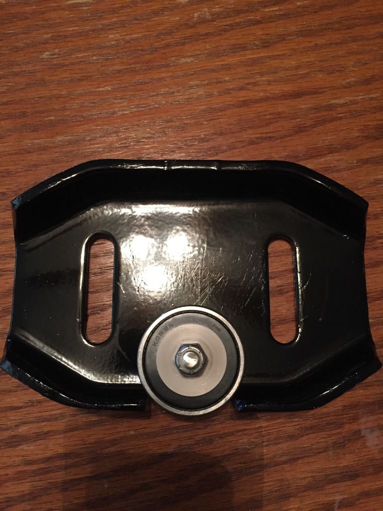

Well I put BB on my skids for when I get the auto turn kit for the ariens
Used flat head stainless screws with spacers in the bearing to put it in the center of the skid and the bolt can be tightened up. Also the bearing sits a little less than 1/8 of a inch below the skid so the skid will still work as intended if any bumps should get in the way.
Left just enough space to scrape anything that decides to stick to the bearing but don't think that will be a issue

Where did you get the bearing?
Is there a bearing #? Diameter? Inside shaft size?
I'm considering using a rollerblade wheel, any thoughts on that instead of using a rollerblade wheel?

Very cool idea. I'd apply an ample amount of grease to the outside seals to prevent water ingress to the inner bearings. I'd probably go with a rollerblade wheel due to the better rolling grip plus there are no side seals to get damaged while turning the machine if it were to bring up on anything.

Roller blade mod.
- Ariens - bearings 22x9x7 mm, wheels 85mm
- Husqvarna - bearings 22x8x7 mm, wheels 82mm
- Craftsman - bearings 22x8x7 mm, wheels 72mm
