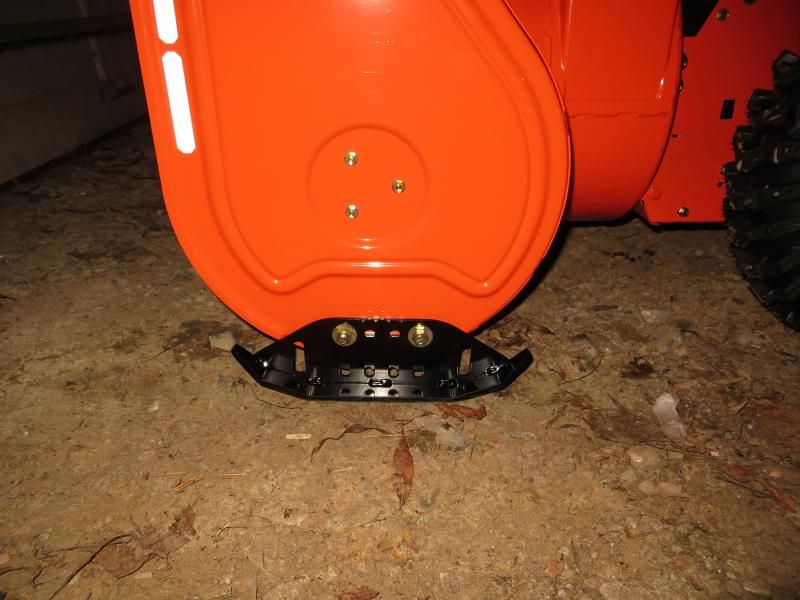

I'm not vmaxed , but ...
For me the longer length helps the bucket and scraper bar ride up over the high and low spots on my driveway and road without scooping up gravel. Also they float better when the ground under the snow is not froze up and is soft. Some folks have had issues with the stock skids digging in on one side or the other and the auto turn wanting to head that direction.
Slots are 3" centers , 2 sets of the shims .
On my unwaxed garage floor
