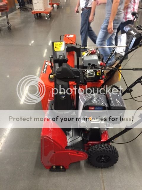

+4 for the Snowmaster
After one season with an 824 I think its the best machine for typical snowfalls (< 12")
It is light and nicely balanced
The snow discharge chute control is close, super smooth and quick (no bending down or rapid cranking).
If I were a kid again and looking to make money by doing the neighborhood driveways this is the machine I'd want because its so fast and easy to sling around
By being propelled by the wheels and not the paddle it doesn't require any forward tipping motions like a single stage does.
And it's small and easy to store. The Ariens in the pic is a Compact 24...
