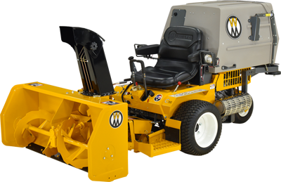

Walker has a mower that can handle a snowblower from the factory, and I think that I've read good reviews on it.
The Walker H12 Two-Stage Snowblower
Again, this may be units that have Heavy (or Very Heavy) Duty transmissions..
