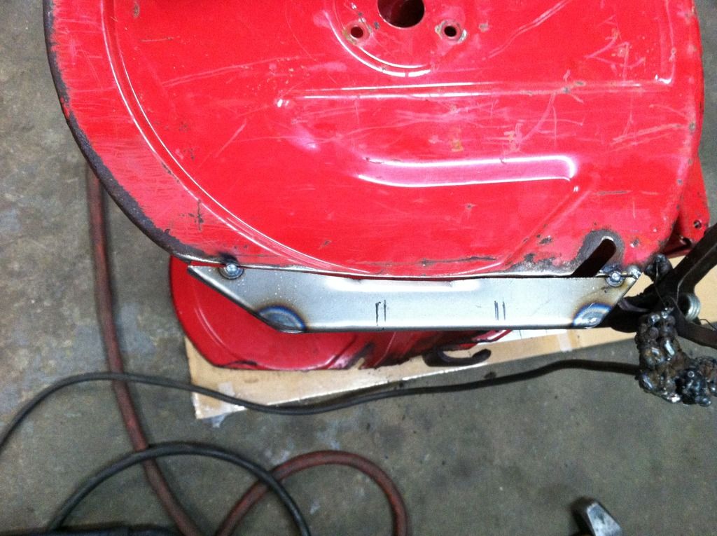

And please keep an eye on your skid adjustment. It just hurts seeing those expensive machines with ground down auger housing bottoms because some fool wasn't paying attention and just kept running it right into the ground.
The photo is stolen from YSHSfan

Ouch!! That is bad!! I'm going to put a set of side skids on it. Cheap insurance.
