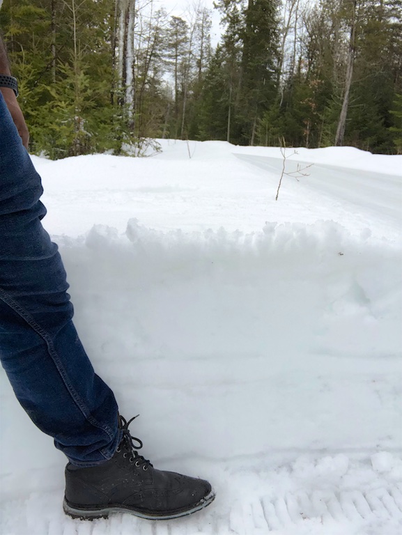

I still need to figure out how to do the oxford heated grips with the battery to connect to. I was mightily impressed that the blower cleared out the hardpacked snow that had been there all winter
