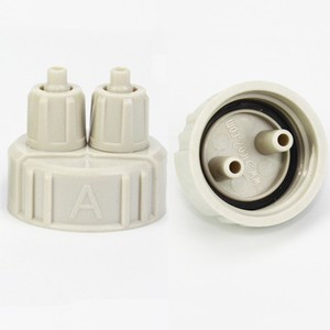

Quite a few lawn mower hydros are advertised as lifetime too. IMHO if that oil is left alone in there the "Lifetime" is shortened. If the hydro didn't come with a drain I'll use a hand held vacuum pump to suck as much oil out as I can and then refill with fresh. It's worked well for me on all the units I've done it to. Finally got tired of the little container that came with the hand pump for brake bleeding and purchased a cheap cap that fits a two liter pop bottle.
Ebay, Amazon, ... They are common for use with making CO2 for aquariums and cost a buck or two.
Works great on transmissions that are starting to slip a little. If you catch it early it's usually only the (black) fluid that's breaking down and not the hydro physically inside.
You can get the vacuum pump for $25-30 or some auto stores loan them out. You can see the little container it comes with is a pain to keep emptying. Auto stores will also recycle the old fluid for free instead of throwing it away.
