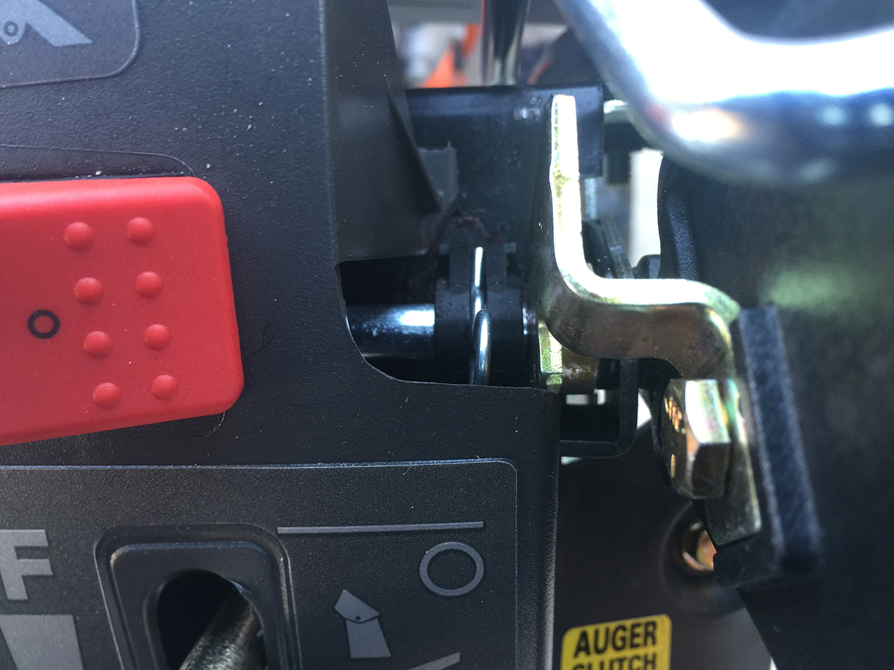

1st Pic. Drive Side Lever
2nd Pic. Auger Lever
3rd Pic. Auger Lever held Down
As you can see, there is the interlock rod that runs betwenen the Drive Lever - Auger Lever. There also appears to be a ~catch~ bracket affixed onto the Auger Lever
I don't see any other hardware though the get's moved when I depress the Driver Lever that would latch onto the Auger catch bracket.
For all ya'll 300 series owners out there, if you have any insight, much appreciated.
