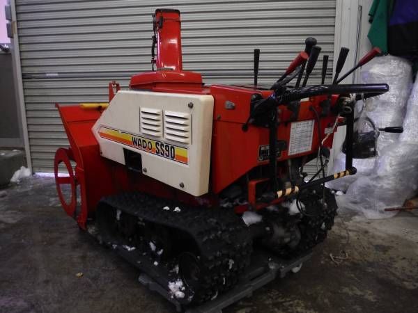

Thanks (Received): 82
Likes (Given): 81
Likes (Received): 401
I believe that's an export version of the Wado SS90.
What's the length on those tracks?
Yanmar Ronin is offline
