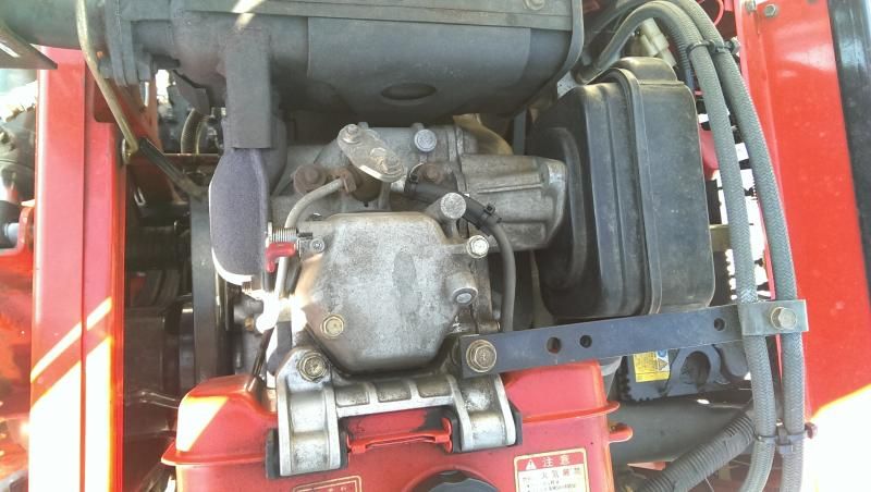

To know that I'd be prepared for those little pre-dawn emergencies I inspected and tidied the engine compartment once I got some time to see, the only real problem I found was that the return line from the injector to the tank was seeping, so I fixed that. New line, and a sleeve to prevent the chafing that caused the problem in the first place.
Nice and clean even after 20+ years of duty:
So far so good.

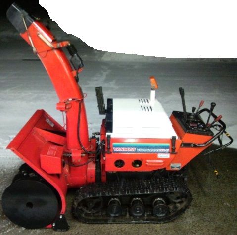

Profile pic:
Looked good to me... freshly serviced including new cats. 'A' in the model designation indicating diesel power, 'E' indicating full electronic chute control.
I immediately had it strapped to a pallet and on its way here.
That machine needs a little trailer, with a seat, large snow wheels, heated cab, and a beverage warmer (optional) so you can ride along in comfort while doing the job. Looks like its big enough to tow it behind, maybe also a small car.

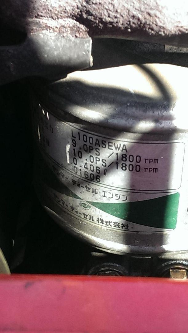

I was looking at that sticker wondering why it looked familiar.
Oh yea, I have a sticker with a green bow tie on mine.
Sticker looks a bit toasted on top.

No link to the specs but they're in my owner's manual, here's the highlights.
Length: 1775mm (70")
Width: 960mm (38")
Height: 1675mm (66")
Weight: 368kg (811 lbs)
Engine: Yanmar Diesel L100ASEWA, 406cc, 9hp continuous/10 peak @1,800 rpm, electric start
12v electrical system/fan driven dynamo/regulated
Auger diameter: 420mm (16.5") Impeller diameter: 340mm (13.25")
Chute rotation: L120*/R120* (really sounds cool when it's shooting at max past your ear)
Clearing capacity: 60 tons/hr
Throwing distance: >15m (>50ft)

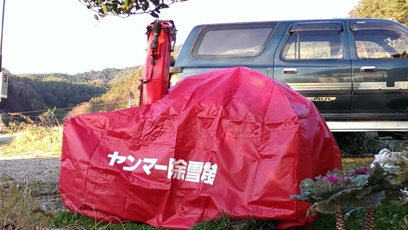

She hibernates through the summer in the shed, kept ready for duty on the line during snow season. Probably got enough scrap house bits now to erect a small temporary lean-to or something, thinking on it. Someday, garage.
In the meantime she has a personalized jacket.
