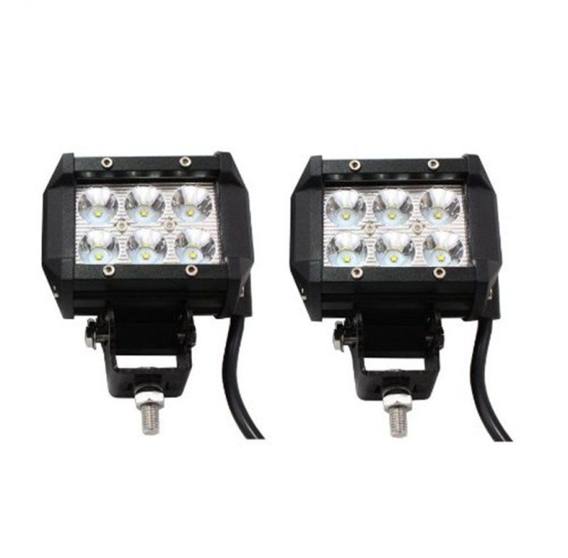

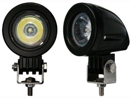

What I found thanks to posts in the LED thread was these
...for the upgrade to LED front light, and also
...for a rear light and possible chute light.

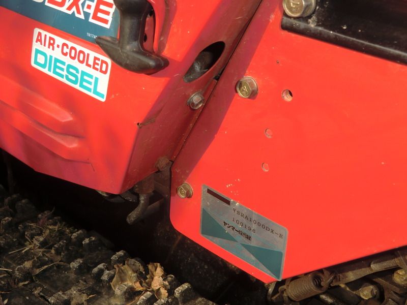

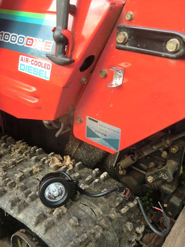

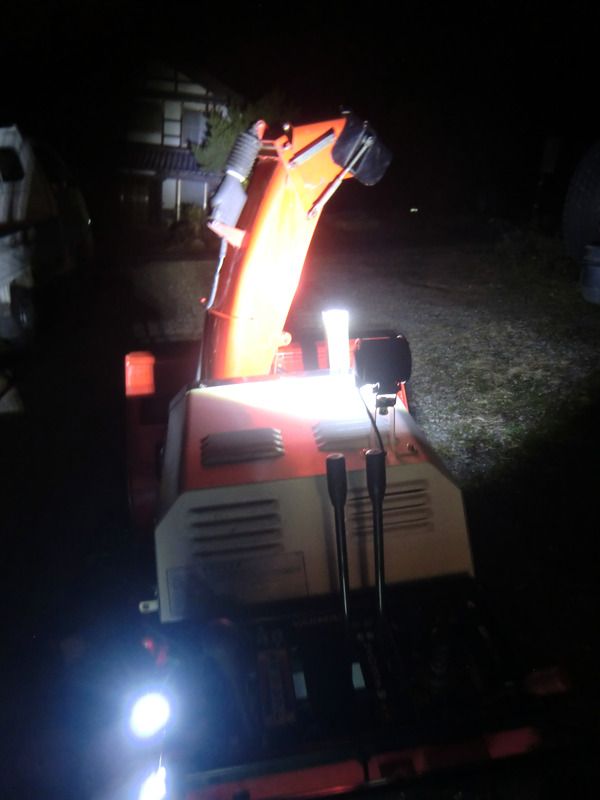

Finally got around to some install a week or two ago, very pleased with the results. For now, one 18w headlight mounted on the original bracket:
The included bolt fit the stock threads just right, included nut added as an additional locknut, because, why not.

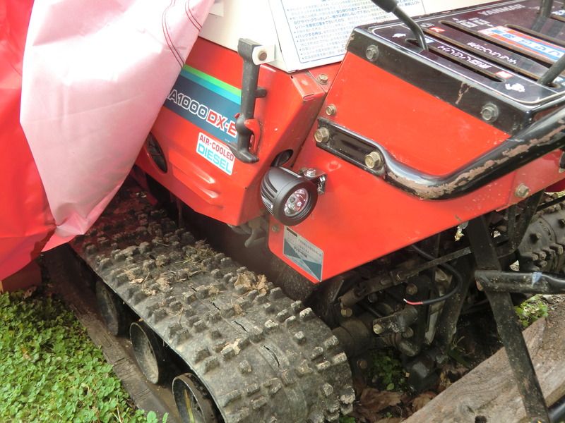

And one 10w for the rear, mounted via a fortuitously placed factory threaded hole/welded inner nut, which would support the chute control shaft bushing bracket on a manually operated unit. Just sitting there empty...
...waiting for some purpose in life.
The light's hardware (M6) bolted right in, and again I was able to get an additional lock nut on the other side. That also provided a nice place to ground the unit so I only had to run a power wire up to the lighting connector.
Previously mentioned Result:
Do Like.

WOW, great light output.......seriously!!!

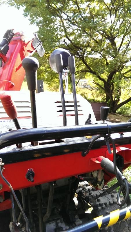

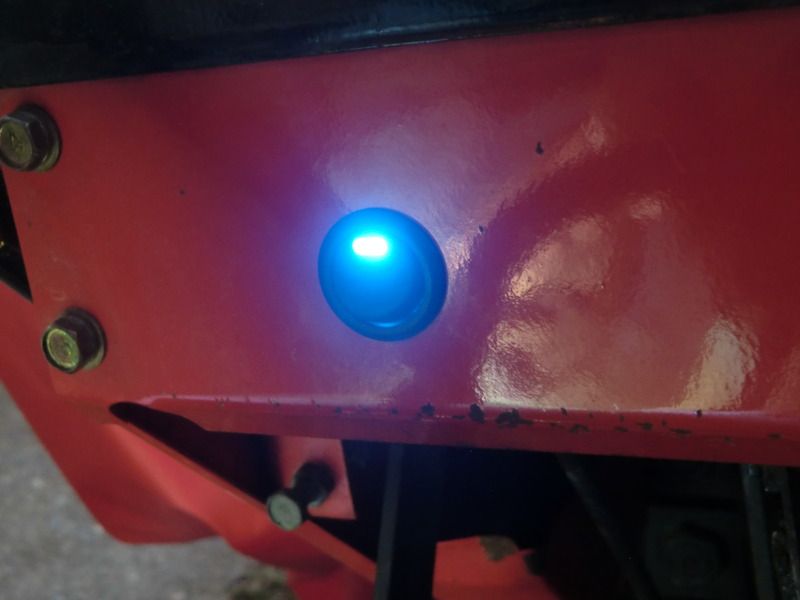

Oh yeah the switch...
Camera not wanting to cooperate tonight...
Perfect @20mm, just had to file an index slot, nice and shallow so no more interference worries. Lit when lights on, option to be lit when key on just by switching two wires. Rated 15a at 12v so plenty of capacity.
Not waterproof... not thinking it's going to be an immediate problem but I found one of identical physical and electrical dimensions equipped with a boot on the 'zon just in case, red light though. Might swap it when it comes, we'll see.
