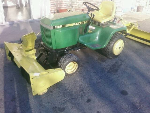

First season with a JD 318 49
This will be my first winter with my JD 318 with a 49 snowthrower. I know it's only a single stage blower, so I don't know what kind of snow it will like. Any pointers and/or things to look out for would be greatly appreciated.
I've got my cab on ready to go, so we probably won't get any snow at all
Here's a pic:

Awesome rig there Matt! I especialy like the cab, that'll do a great job of keeping the blowing snow out.
Also, welcome to the forum!

As for tips... keep the housing, and chute clean, and smooth. Also keep the revs up. Thats what blows the snow. One other thing to remember is the single stage blowers like to be filled with snow. Those 1-2" snowfalls can be a issue unless you go fast. So adjust your ground speed depending on the snowload.

Really nice outfit you've got there! Lots of people sing the praises of the JD 318. Bet you're really looking forward to getting out there with it.
I've read where others use Pam spray on the inside of the chute to help keep them from clogging. Never tried it myself, but if the wife isn't watching this morning, I'll sneak some out of the kitchen and give it a try later this morning.

MrMatt57, I see you have the late model 49 with the tall chute/spout all of us short spouters dream of. How has your set up been woking at full WOT?
