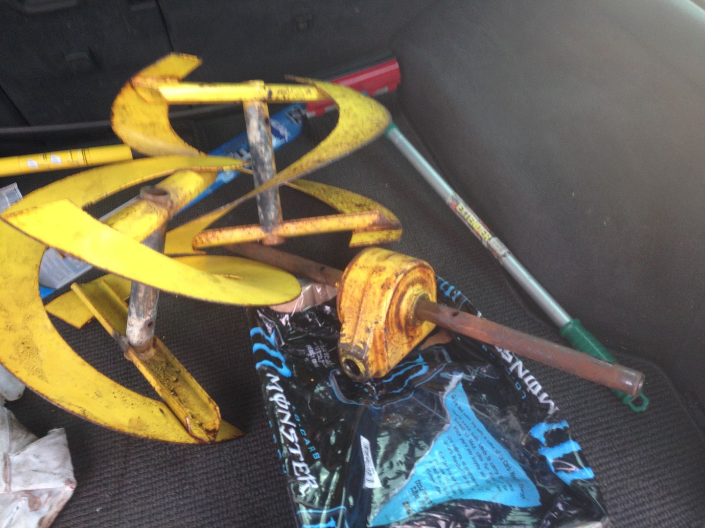

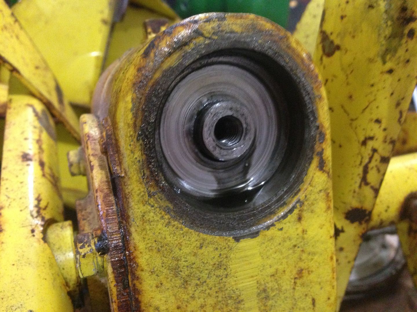

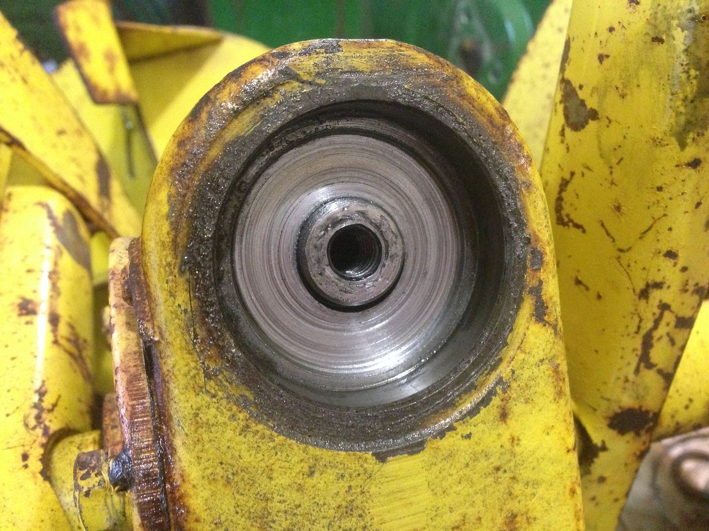

I am working on a friends 826 and have a question for the group.
This is the back side of the blower impeller. As you can see there is a pice of metal welded on the back side. I am guessing that this is on there so the shaft assembly doesn't go to far back, but not sure. As you can see it is worn out completely.
I can't seem to find out any info on this, but that is my best guess. I am assuming it got that way because the bushing that the shaft goes through is also worn out.
Is there anything else that I should be looking for at this point?
The repair started out that he couldn't get it started and burned out the starter, fixed that, then every time I tried it out in some snow it would quit blowing, which lead to noticing the slop in the auger shaft with the pully on it.

My guess at first was a stiffening thing, but on only one side I would probably rule that out. Maybe it was there as a counterbalance like wheel weights on a car?
If the impeller shaft it loose forwards and backwards I would say the bushings in the front gearbox are worn out.

Thats what I was thinking. Not exactly where I want to go with this one but might have to. It started out as a simple carb cleaning and replacing the starter. Now it just keeps getting worse the farther I go. He is paying me for parts, but didn't really think it would need any of this extra stuff. I have a new bushing assembly coming for the impeller shaft, so I have some time to look into the front gear box assembly.

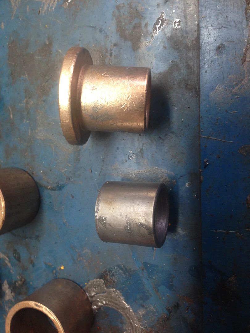

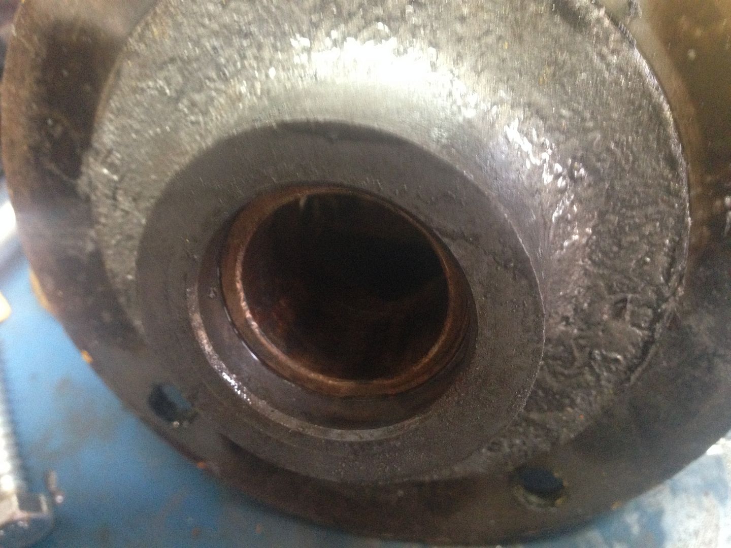

Well I got it apart, and the front bushing is shot. In fact there nothing left of the bushing that controls the front to back movement.
Here is the new bushing I got.

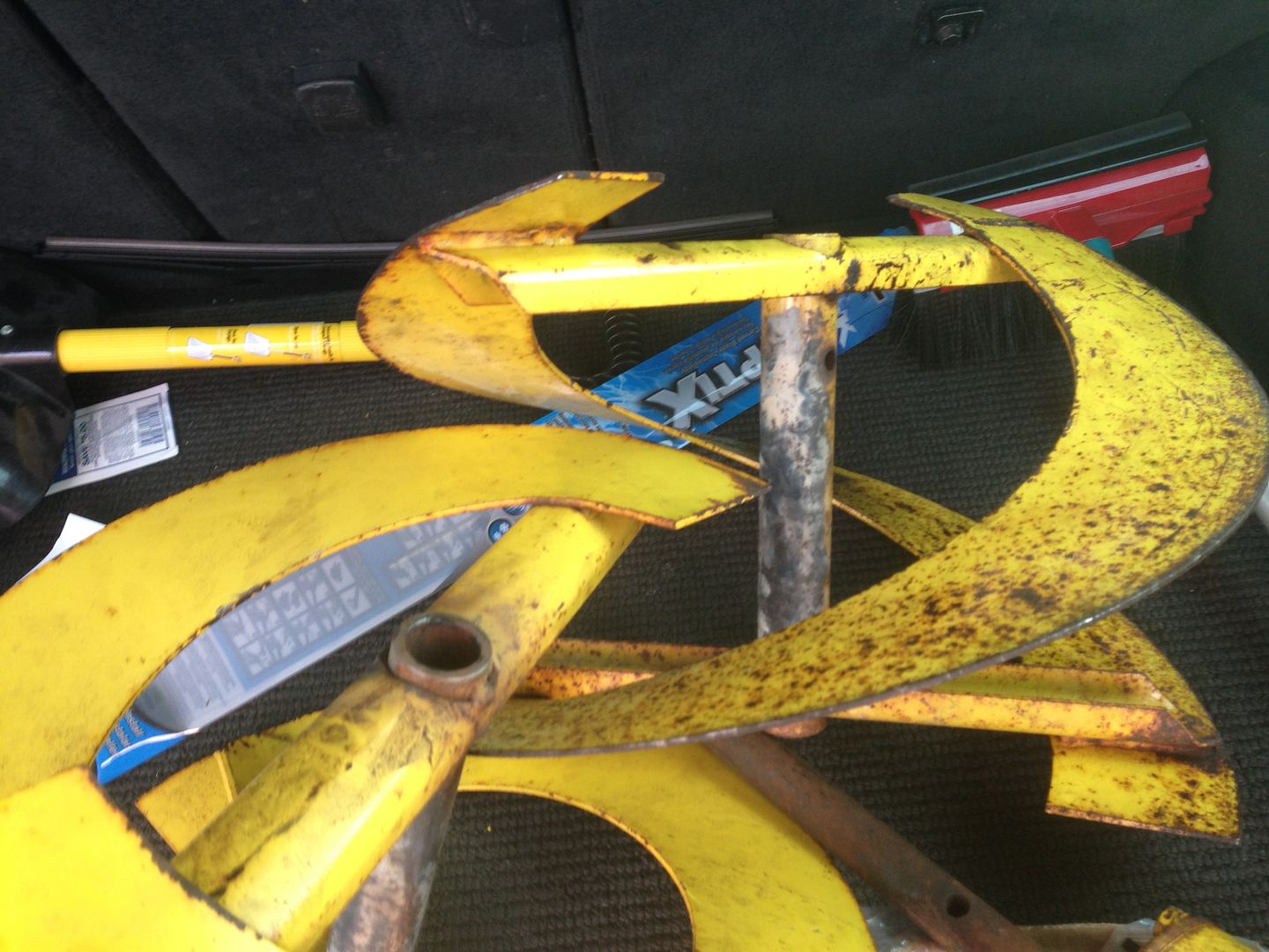

So, now the problem I have is that I need to get the augers off so I can punch out the old bushing, but I don't think the have moved on the shaft in a long time. Been using my MAP gas torch and penetrating oil, I think I might need to have one of my mechanist friends help me get it off, not a one person job.

You could try drilling and taping a couple holes in the bushing, screw in a couple short bolts and use a puller or a pry bar to remove it???

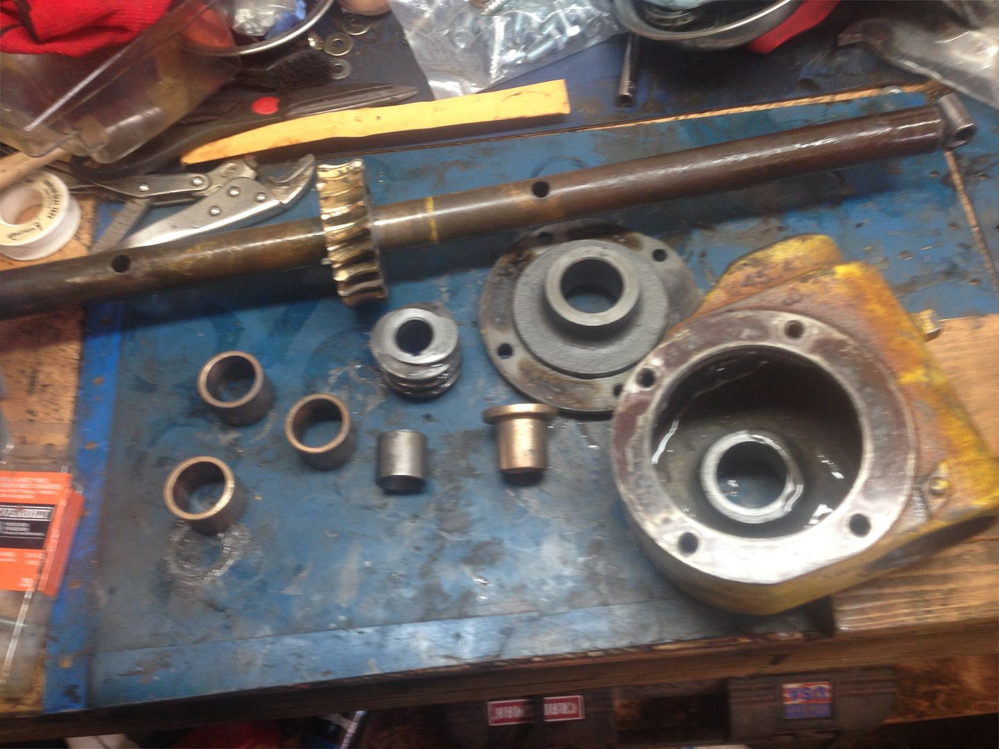

Well in order to replace the auger bushings I needed to get the augers off, so I could get the shaft out, so I could hammer the old ones out. That was a lot more work. I ended up having a friend who teaches automotive repair help me get it off at the shop. Oxy/Acetylene torch and a air hammer, and it is free.
Guess I will be doing some painting after I get this reapired.

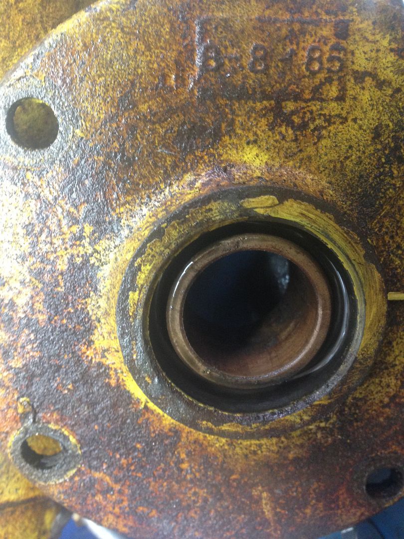

So now that the housing is free I could drive out the bushings. That went very nicely, for a change. As you can see the front bushing was completely worn out. The bronze one is the new one, and since it was all apart I might as well replace all of the other ones. They didn't look bad, but its apart so let's replace them and make it good for another 30 years.
