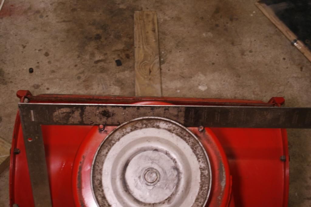

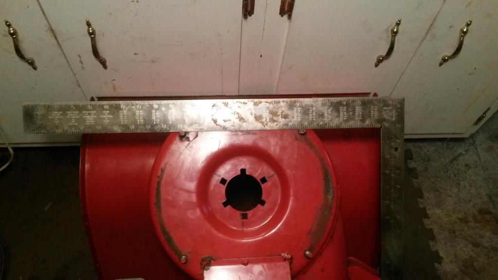

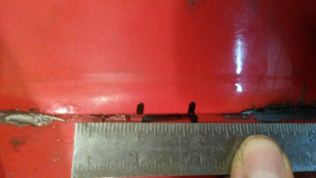

if it's still twisted once you free it up, you may be able to salvage the housing by grinding off the welds, correcting the twist and rewelding.
My 824 was twisted by a mere 3/16" which translated into nearly 1/2" at the skids and made the machine a PITA to control.
