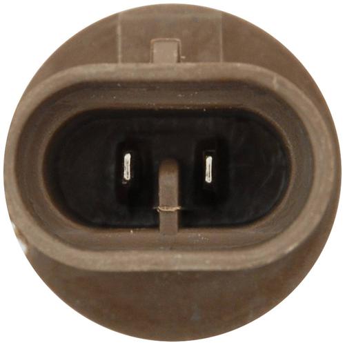

Hi, I need to replace a blown hologen bulb. They are $30 plus. Would anyone know of a much less expensive alternative? Thank you!

I don't know for sure but I think it's an #880 / 27 watt. Should be about 8-10 bucks. Once you have the bulb out take it with you to an auto parts store, walmart, .... where you can compare the plug in and that divider in there and the way it screw locks into the reflector housing.
Photos of both ends: https://www.oreillyauto.com/detail/b...15?q=880&pos=0

BTW, don't touch the glass of the new bulb. Halogens burn very hot and it's possible the oils from your fingers can soften the glass under the extreme heat and cause it to blow out and fail early. Should you touch it just use glass cleaner or alcohol to wipe it down.
This would also be a great time to switch to a LED. If it is an 880 or whatever number you can likely get one on Amazon or Ebay in a couple days. Just a thought
https://www.superbrightleds.com/sear...ent-bulbs/880/
